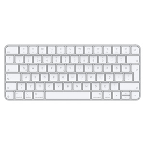

What Keyboard Layout did You choose? Could You make a Picture of Your Keyboard?
Turkish F layout sir.
Hmm ... maybe the Layout doesn't fit quite right with the Keyboard ... So, pressing the Lock Button alone doesn't works, yes? Did You tried it with a Key-Combo like Option+Lock or Command+Lock?
Yes exactly only the top right Lock button is not working other buttons except F3 one (I belive GNOME view) so we can say F3 and lock button others are perfectly working. I tried from keyboard shortcuts but didnt help.
Edit: F3 is working, when I pressed mouse cursor disappearing.
Hmm ... maybe Input Remapper could help. It is a Tool for remapping Keys. You can install it with sudo apt install input-remapper and then try to set Your Lock Key with this Function. I don't know if this works but should be worth a Try I guess.
