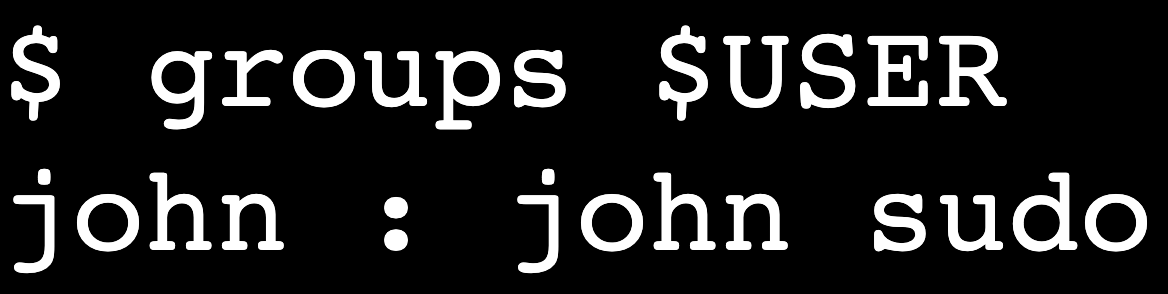

Maybe you need to follow these steps:
Thank you for the help! I actually looked at that install guide first and followed all the steps, however I ran into the same problem that wp-env didn't recognize docker. Therefore, I uninstalled everything and tried docker.io even though it was an "unofficial" package. I read that it was Ubuntu's package for docker that they have in their repositories. I could totally be wrong though.
Looking at the guide Forpli posted, my guess is I am running into issues because my normal user doesn't have the root permissions to use docker because I did not set that up.
Would it be easier to set it all up manually via LAMP?
Thank you! I did not see that and I did not follow that guide. I am still a newbie with all this, so I was somewhat nervous to follow those steps, as I don't fully understand how to mitigate the risks involved with changing root permissions as it suggests. Would it be safe for me to do what it suggests or should I stay away from docker until I know more?
