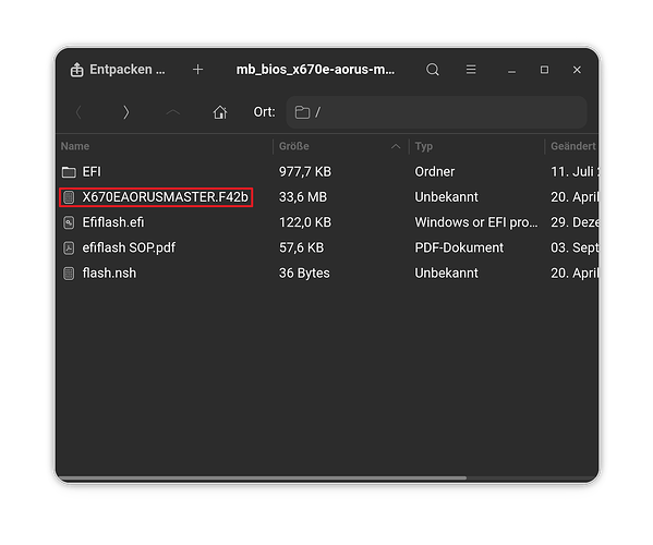

soooo...because I see than fille is a little(0,4MB higher than on webstie, and I don't know than I need EFI folder,efiflash file and flash.nsh) and I just need .F9 file(for F9 vesrion)?
Maybe it is on Your Board different than for mine but I only need the actual File with the .[Version] Ending. I took a quick Look and downloaded the F42b Version.
What I normally do: I create a folder on my USB Stick and name it like the File Ending - in this Case F42b. And in this Folder, I put the File that looks like the one I marked above. Then, I start into BIOS and use there this ... how was it called ... Q-Flash Option or how it was called and then start the Update Process. It detects the USB Stick and I have to navigate to the BIOS File and then the BIOs detects it, check it and then I an start the Update.

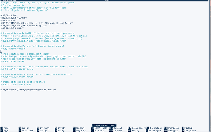

In Zorin open the Terminal and type sudo nano /etc/default/grub and look for this:
grafik
Change true to false and then press ctrl+o to save, Enter to confirm and ctrl+x to exit. And then type sudo update-grub to make the Change affect. Don't forget that!

Oh, You don't have a GRUB Menu active? Then, You have to activate it. Do again this:
and then look for this white Textblock at the Beginning:
Here are the Lines 2 and 3 important. Switch that to:
GRUB_TIMEOUT_STYLE=menu
GRUB_TIMEOUT=20
The last one defines how long the GRUB Menu appears until it boots in the default OS. The 20 makes that it appears 20 Seconds. When You want a shorter or longer Time Frame, You can change that like You wish. Simply change to Number. Or You can set it to -1 and then it appears until You make an Input.

I check and I don't see GRUB_DISABLE_MEMTEST - am I add this?
Hmm ... Well then add it. Add the Line:
GRUB_DISABLE_MEMTEST=false
at the End, then make a sudo update-grub and reboot.
