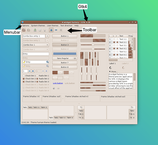

For example, you mentioned that GtkMenuBar and GtkToolbar were removed. However, Gtk4 still provides menu bar and toolbar widgets, which you can see in my annotated screenshot of AWF:
I also know that the newer versions of Transmission (the torrent client) are made with Gtk4 and still use a menu bar and toolbar, so these widgets definitely haven't been removed.

What you see in that screenshot is gtkBox., Not menubar, not toolbar.
It is also gtk-popovermenu assigned under the class gtkheaderbar.
So these can look like or mimic toolbar or menubar to some extent, but they are not the same widgets and have reduced functionality.
