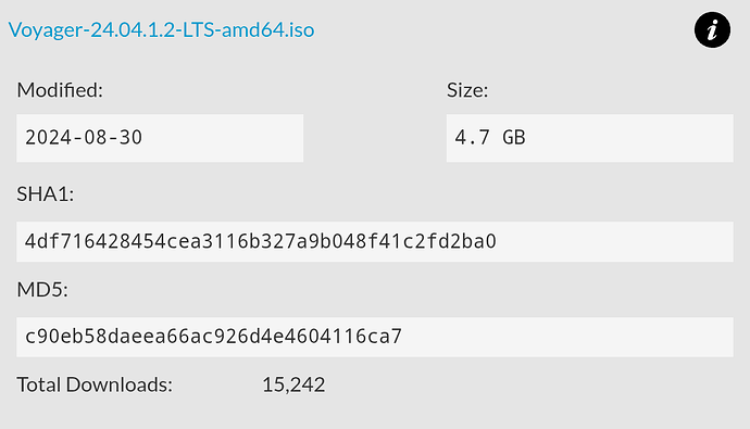

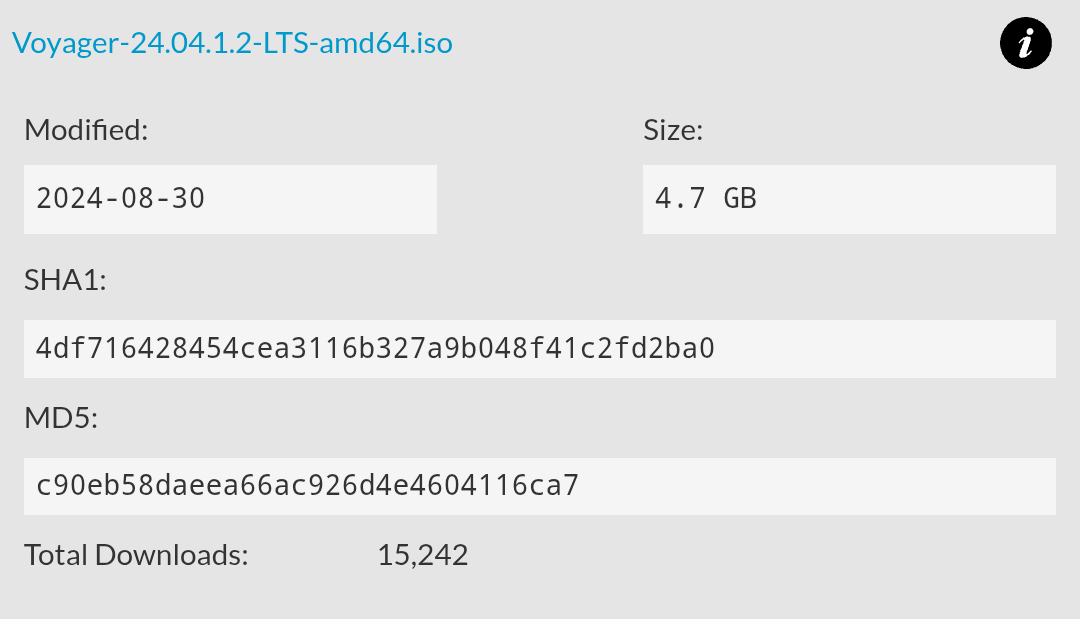

They could if they wanted follow what Voyager has done and include xfce. This takes the image to 4.7 Gb but this is no longer an issue with USB drives compared to DVD's:
Voyager also includes a couple of Ventoy tools, including USB creation with persistence, plus OS eraser and Gnome removal tool!
