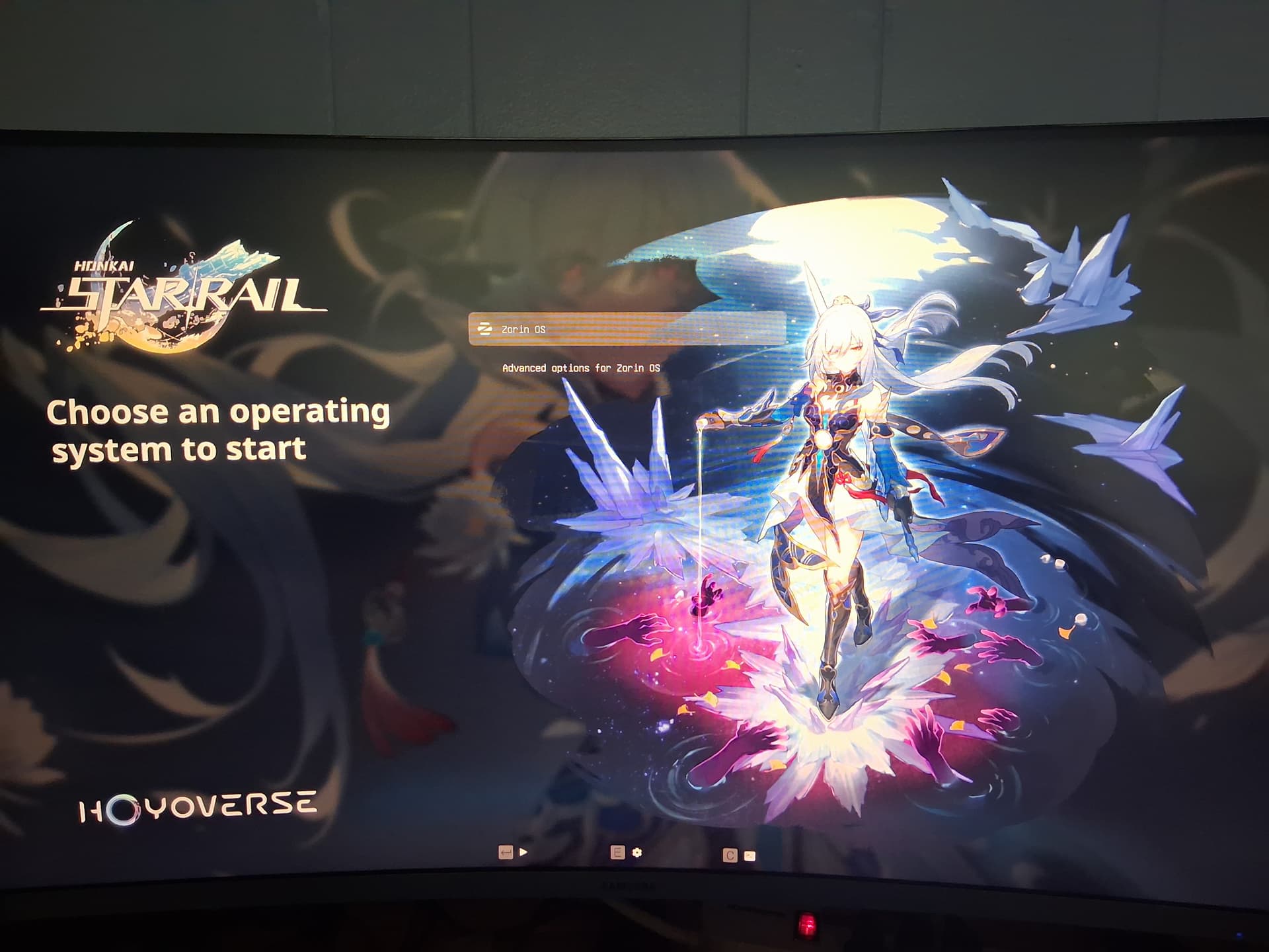

as pertaining to geting to another kernel most computers at complety off you power it on and hit either esc key or tab and a screen like this will popup
mine has a speical background...but then arrow down or use mouse to hit advanced options then choose another kernel by clicking on one you want
