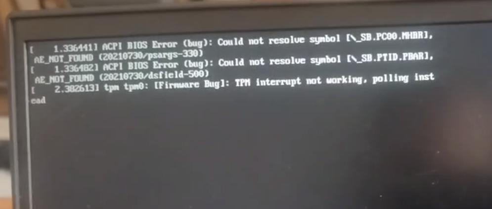

I'm not sure I need to change the log level as such, but I need to be able to read the printed warnings, perhaps there's a way I can force these screen output notices/warnings into a specific file of my choosing (/var/log/loadingboot.log or similar) . Actually, I just thought I can try and photograph it with my phone..... hmm....
This is one of the two errors;
ACPI BIOS Error -->Could not resolve symbol _SB.PC00.MHBR --> AE_NOT_FOUND
ACPI BIOS Error -->Could not resolve symbol _SB.PTID.PBAR --> AE_NOT_FOUND
So my query I think is; now we know what sort of error it is; where should I be able to find this error on any Zorin OS logs? Thanks!

Yes, these will not show up in error logs because they are not errors.
@337harvey mentioned this above.
ACPI warnings are generally harmless. What they mean:
ACPI = Advanced Configuration and Power Interface
What ACPI Tables do: They are specified tables that describe the Hardware Interface to the Kernel or Operating System.
What ACPI Warnings Mean:
If the information in the ACPI table is empty, incomplete or erroneous; it cannot be resolved or may be "not found".
The operating system notes that the ACPI table provided by the hardware manufacturer is missing that data - which you noticed in the print.
The operating system then reverts to the Fallback generic handling. Which is why everything is working on your system, in spite of the hardware failing to identify.
You cannot resolve these without contacting the hardware manufacturer and letting them know that their tables lack data - to which they may not bother with it...
