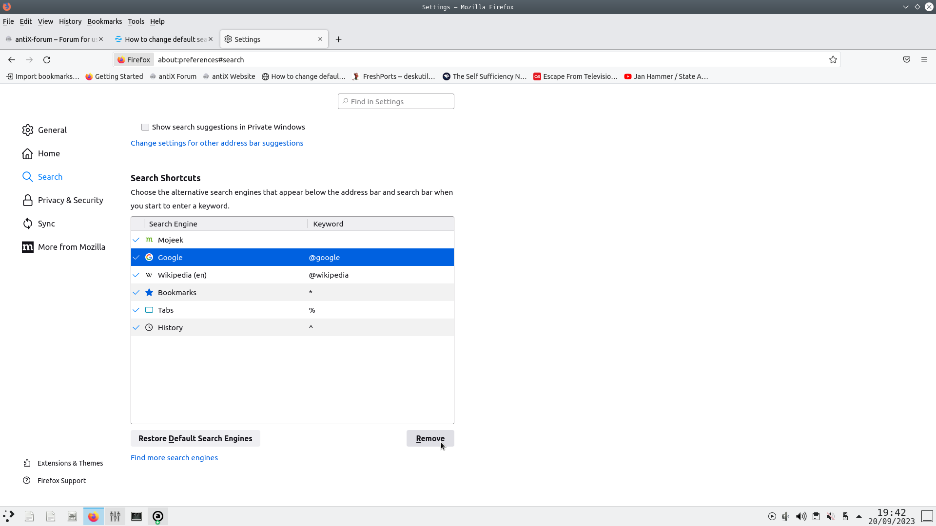

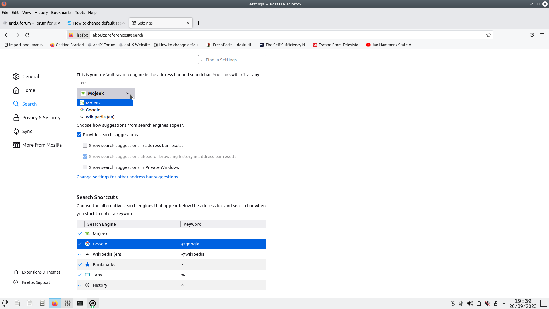

Go to Settings (cog that appears when you use the hamburger (3 bars) top right, then go to Search, choose your preferred search engine:
Then under Search Shortcuts, highlight the search engines you don't want/need one at a time, and after highlighting, select the Remove button underneath:
