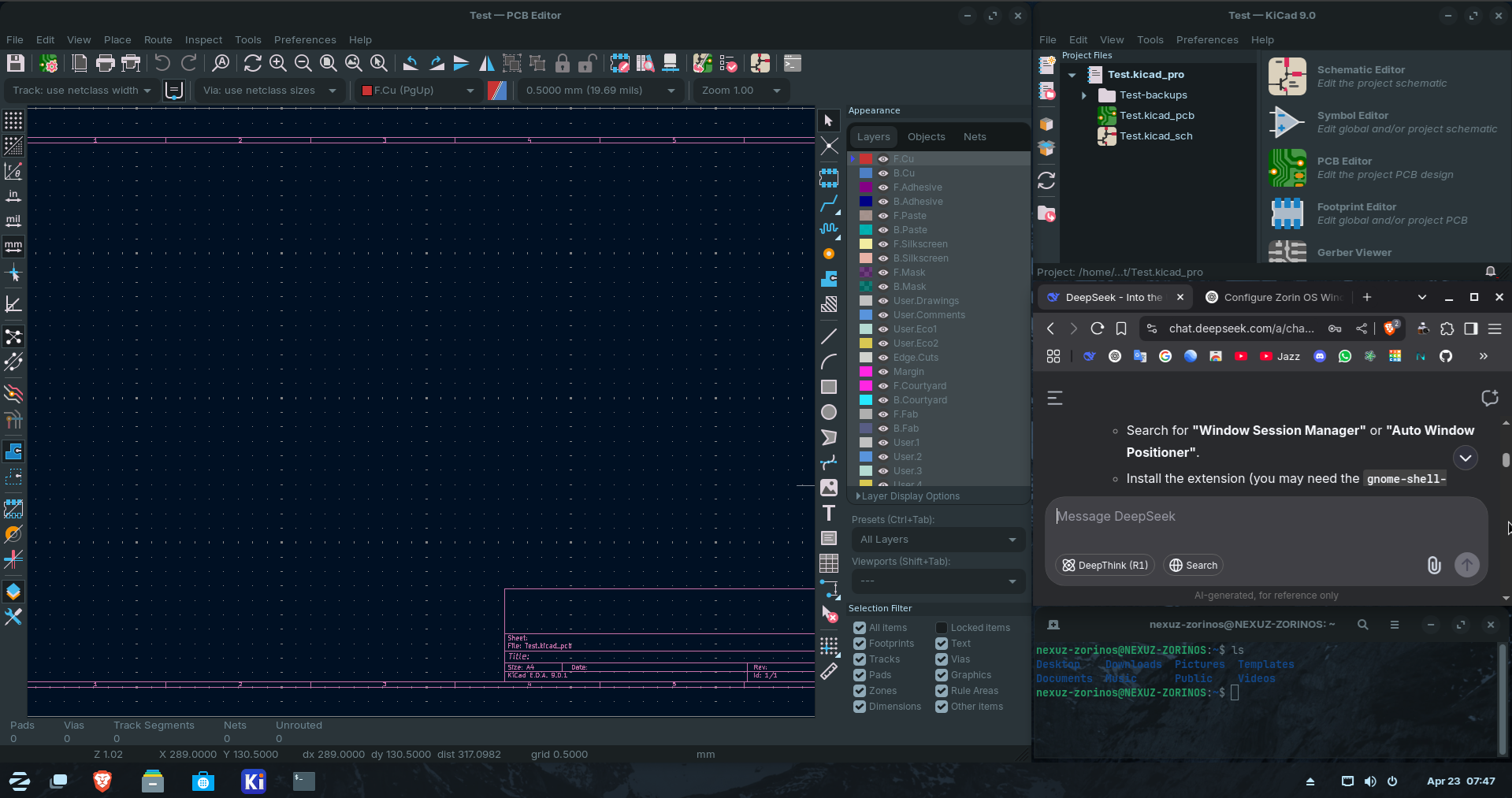

Thanks for creating this beautiful and clean Linux distribution, below is my normal aligned of application panels in daily work:
As you can see, on each startup of Zorin OS, if it can remember respective application's size and position aligned, it would be very helpful and I do not need to spend time to re-align again.

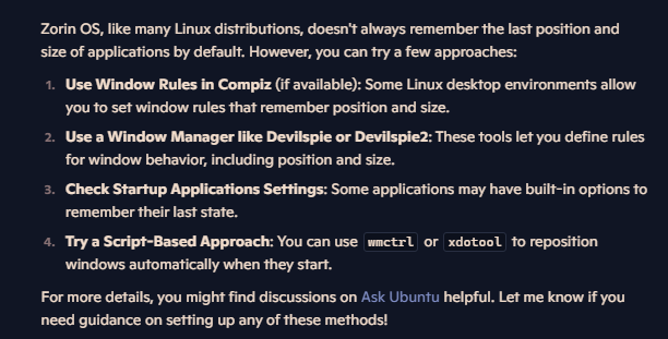

ChatGPT's feedback:

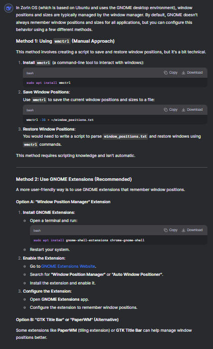

DeepSeek's Feedback:
I am new to Zorin OS, not sure the solution of DeepSeek is implementable or not as I cannot find any Window Position Manager in the gnome-shell-extension browser.

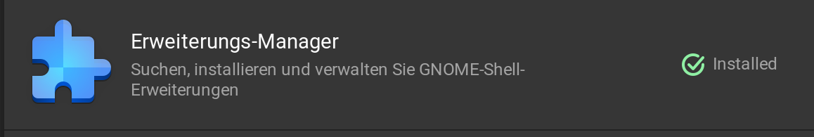

You could simply use the so-called Extension Manager to install Gnome Extensions. That makes the whole thing way much easier. You can find it in the Software Store:
(ignore the Language, my System is in German; the blue Puzzle Piece is important)

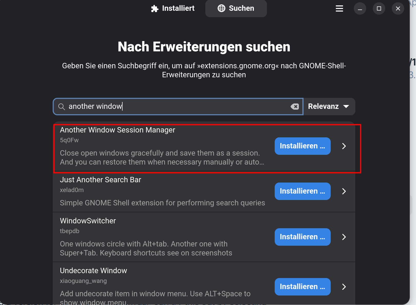

When it is installed, open it and go to the ''Browse'' Tab and search for it:

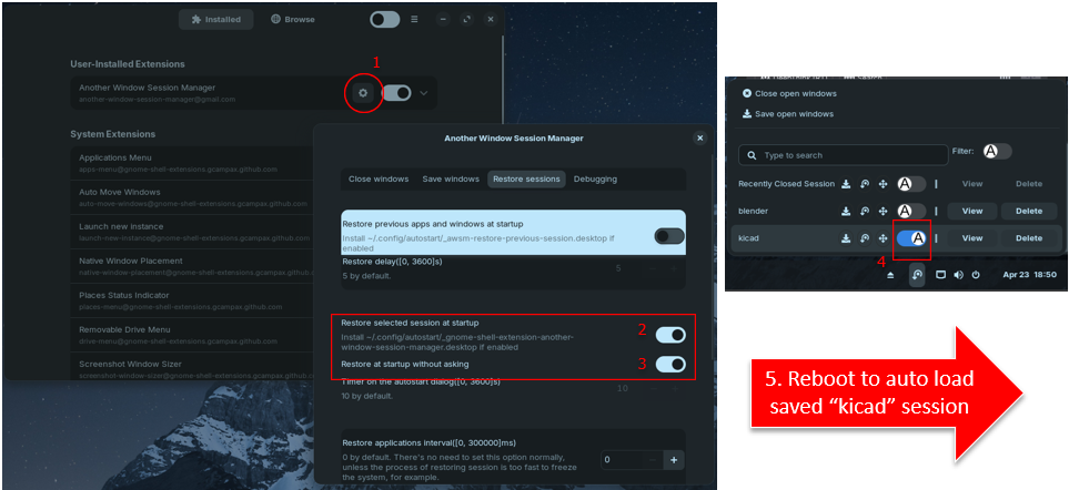

Ponce-De-Leon, thank you so much, just found another settings which automatically load the saved session ( eg. kicad ) as shown in picture below.
Now, the Another Window Session Manager is totally working fine under Zorin OS.
