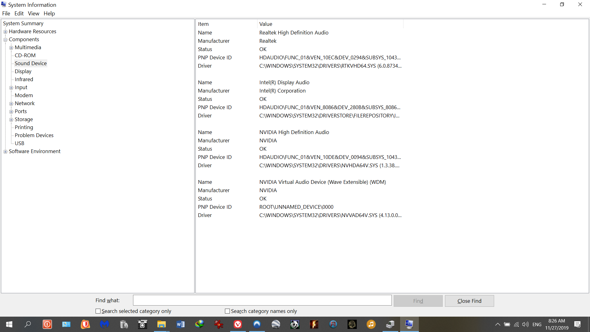

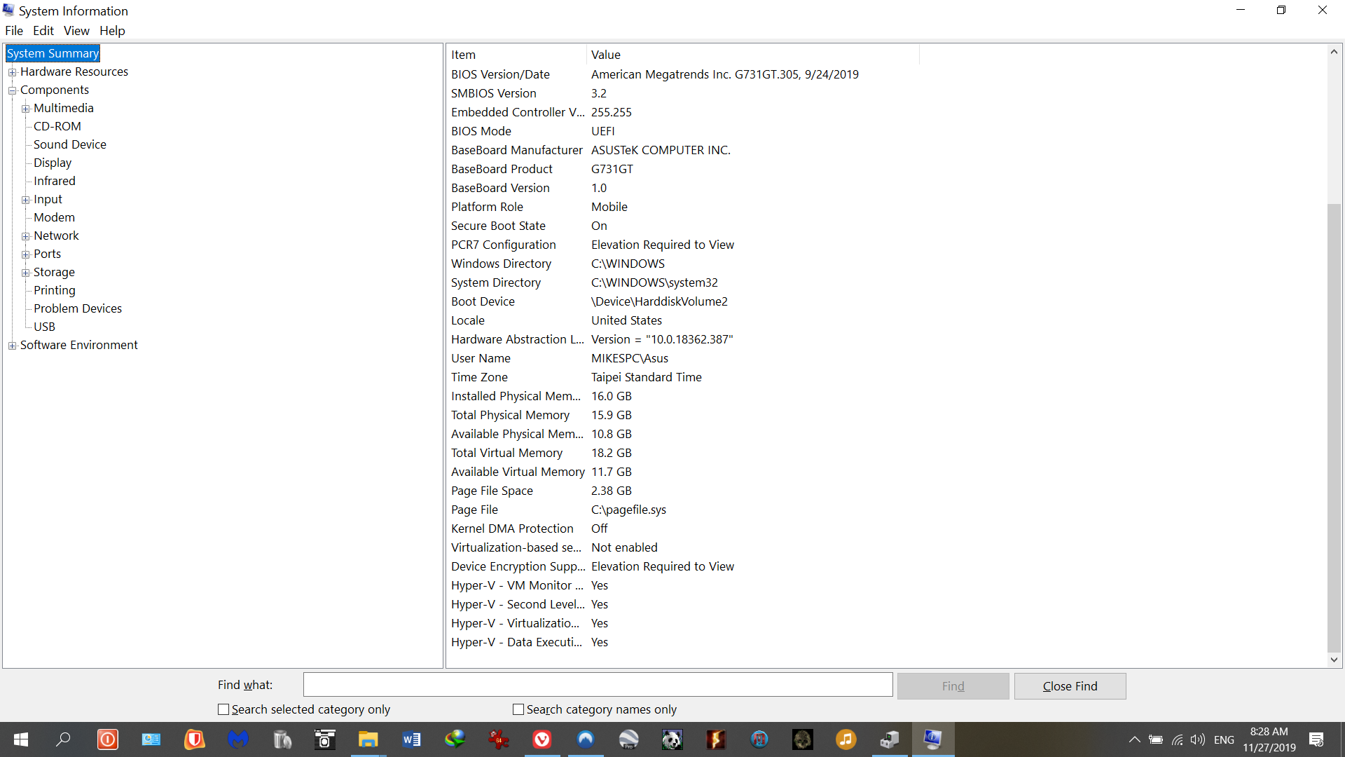

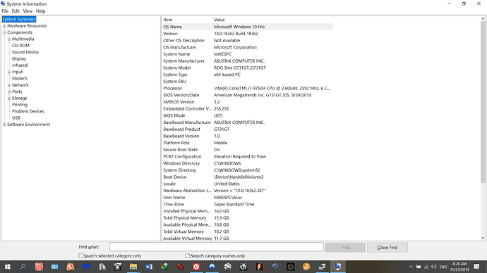

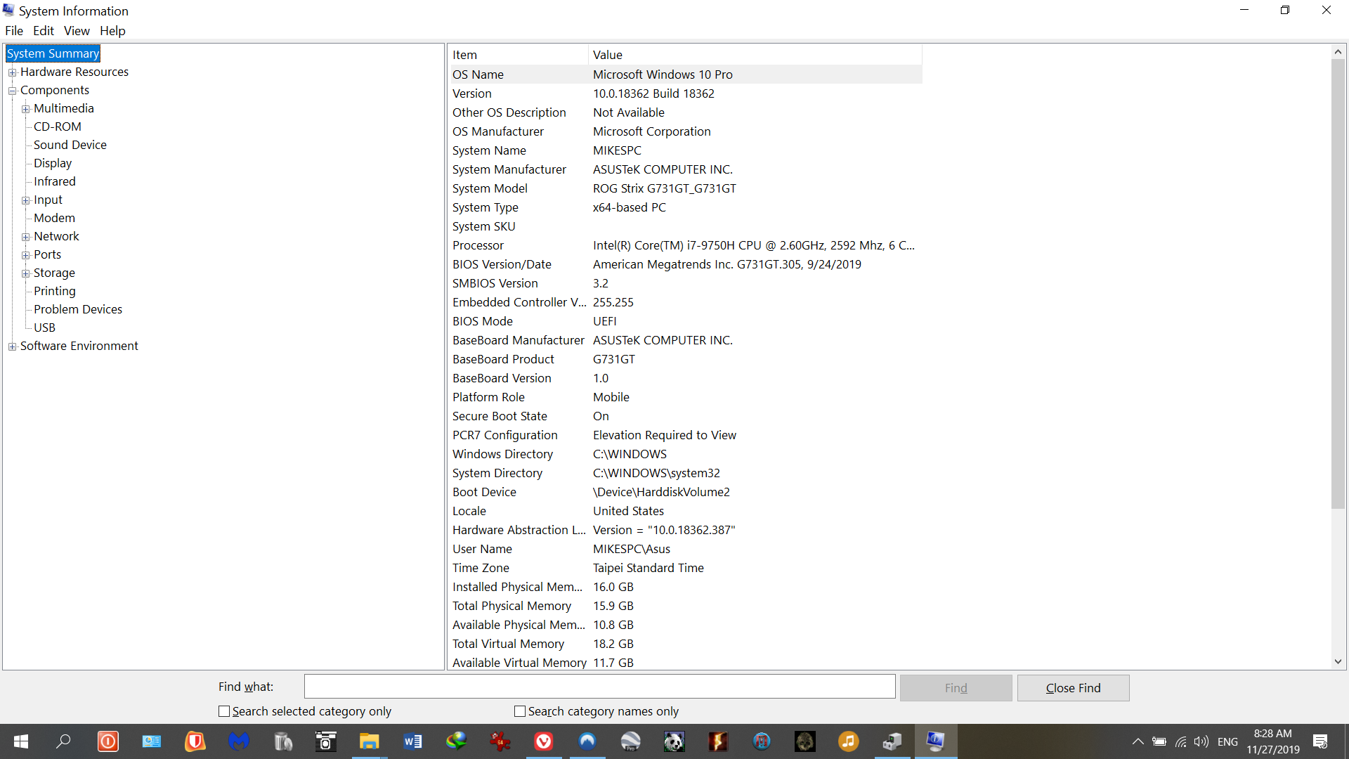

And also laptop spec's sorry it is when I used Windows 10 as I don't have a program to show my hardware now .....

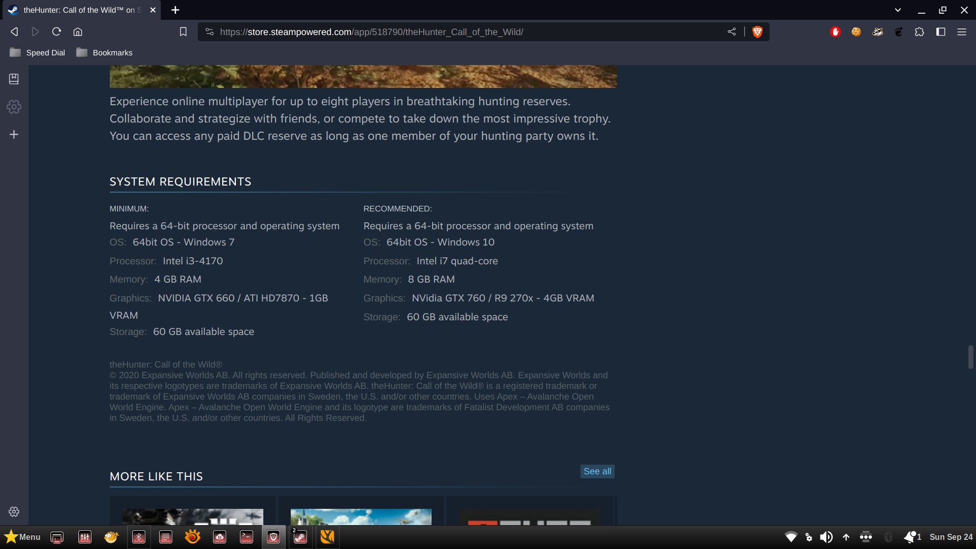

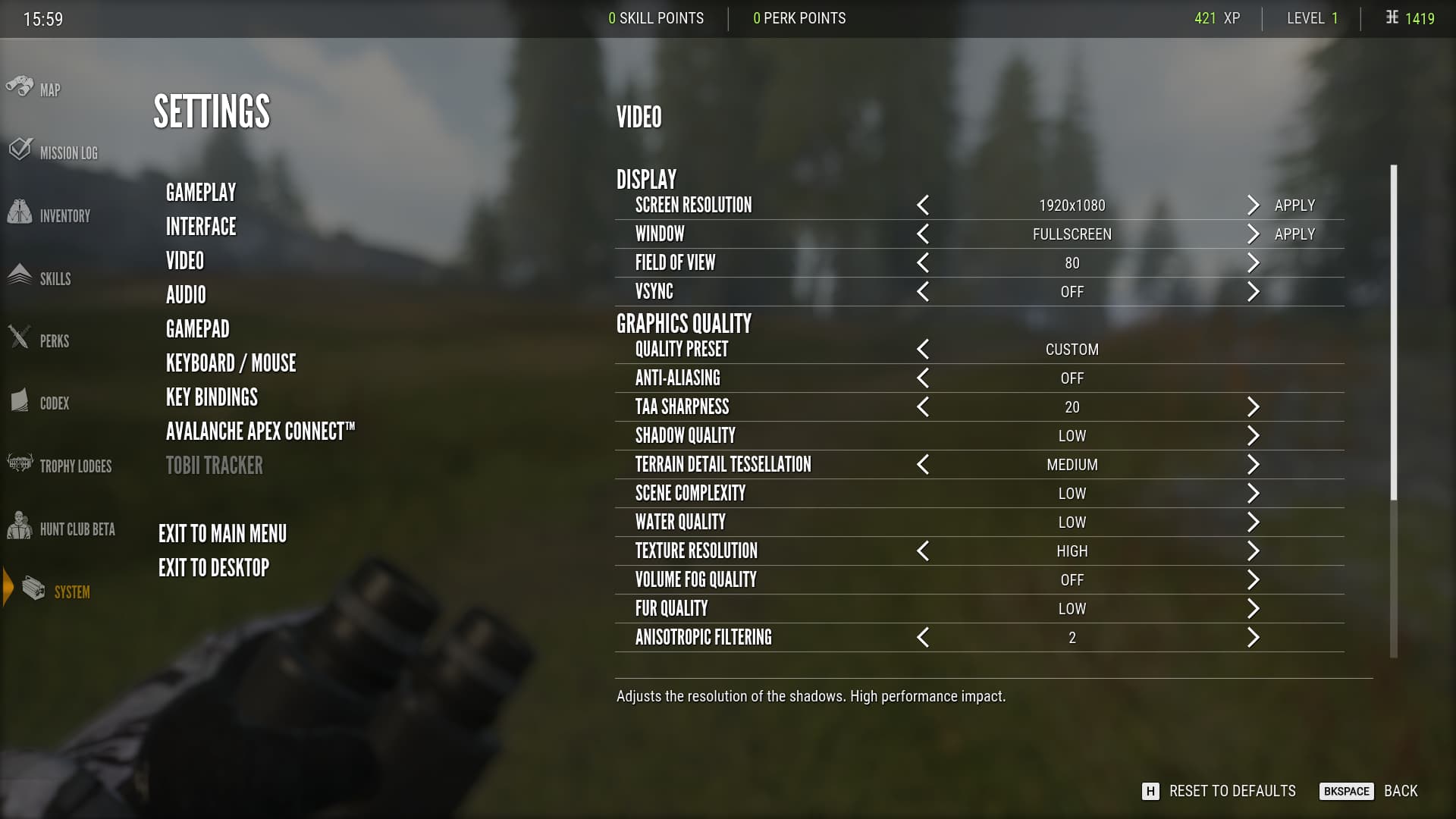

Finally here are the game spec's for my set-up according to game itself ..... I changed the FOV from 60 to80 as described by one gamer and it did help some but didn't help me run a marathon but it was a bit better .....

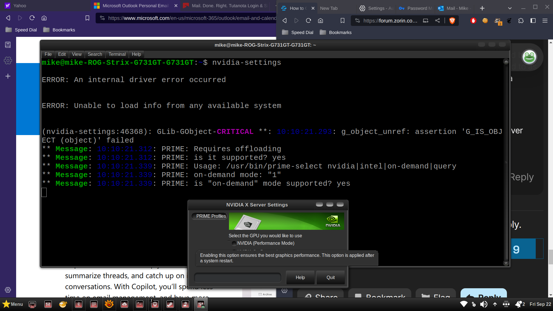

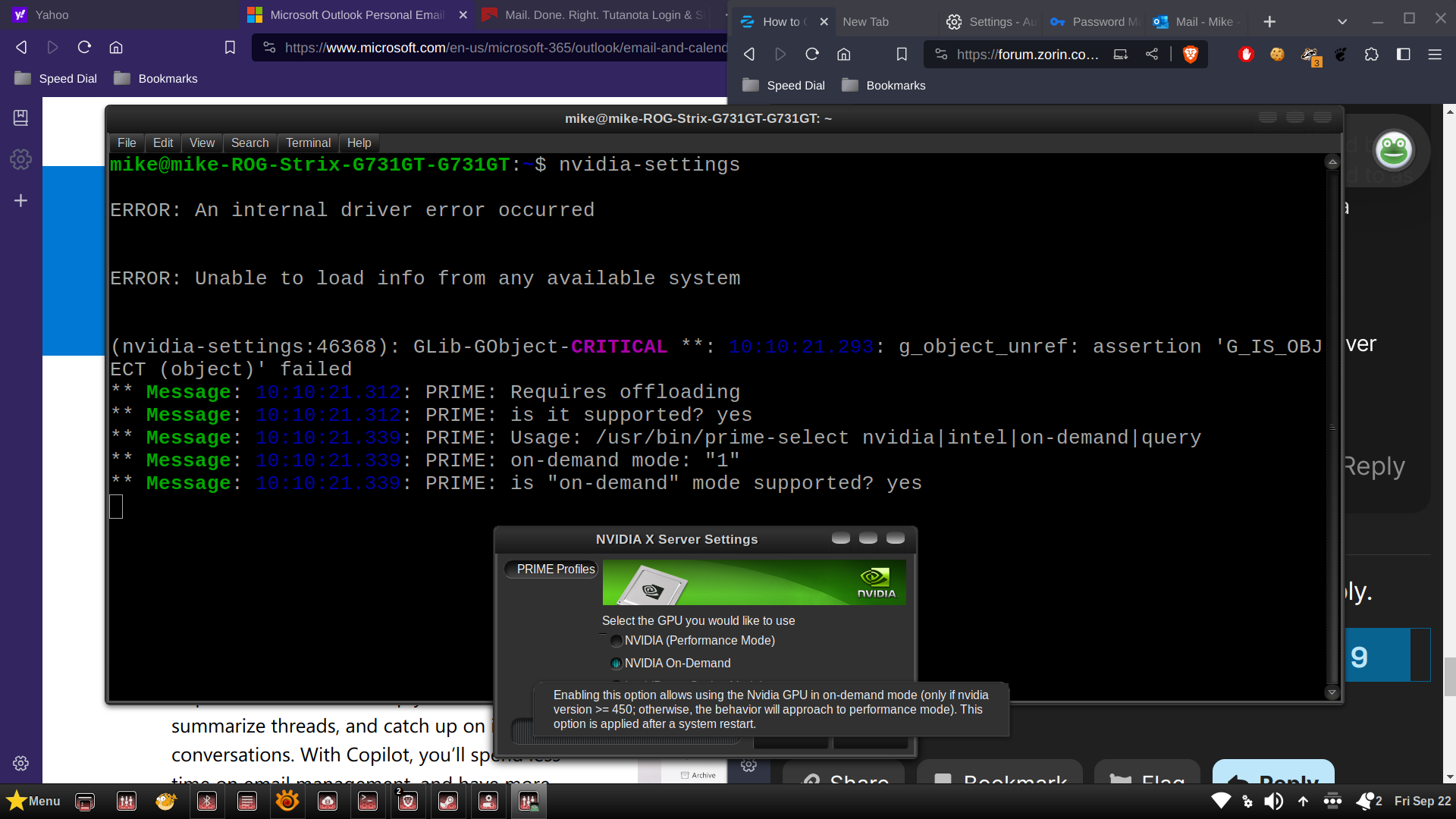

Is Nvidia set to On Demand?

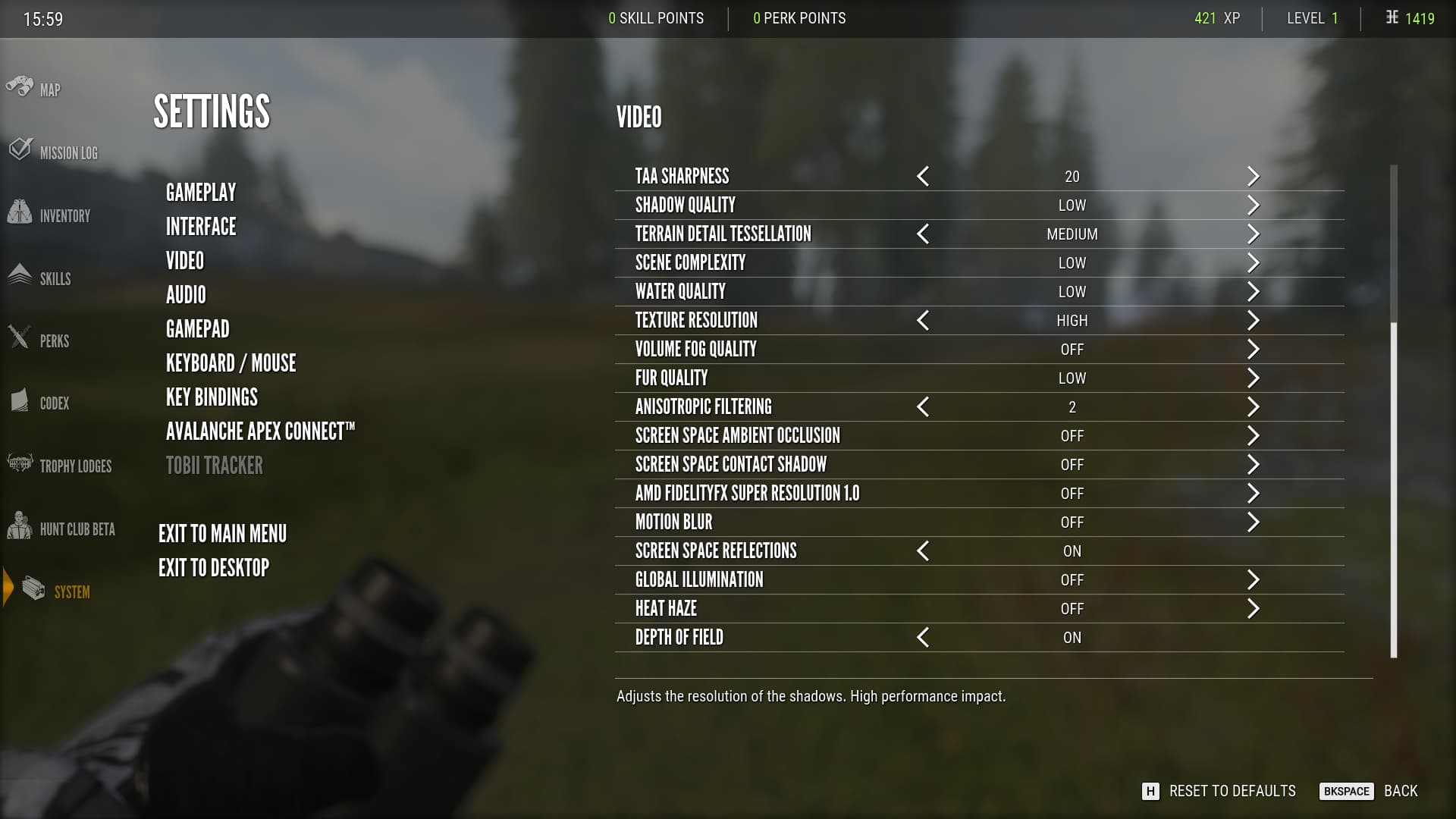

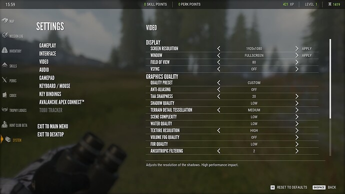

I tried both of your recommendations and they seemed to help some but we still have some problems ..... I went into the video settings and tried out different ones and seemed to make some more progress ..... I turned Anti-Aliasing completely off as I think I remembered that that could cause Lagging .... that helped some ....
Then I put most of the other settings on Low and now I can walk fast in the run mode so that made a big difference but of course the quality sucks .......
Surely my laptop is with in the specs for this game to run .... I even tried the Generic X Org X server Driver just for kicks and that didn't work ....

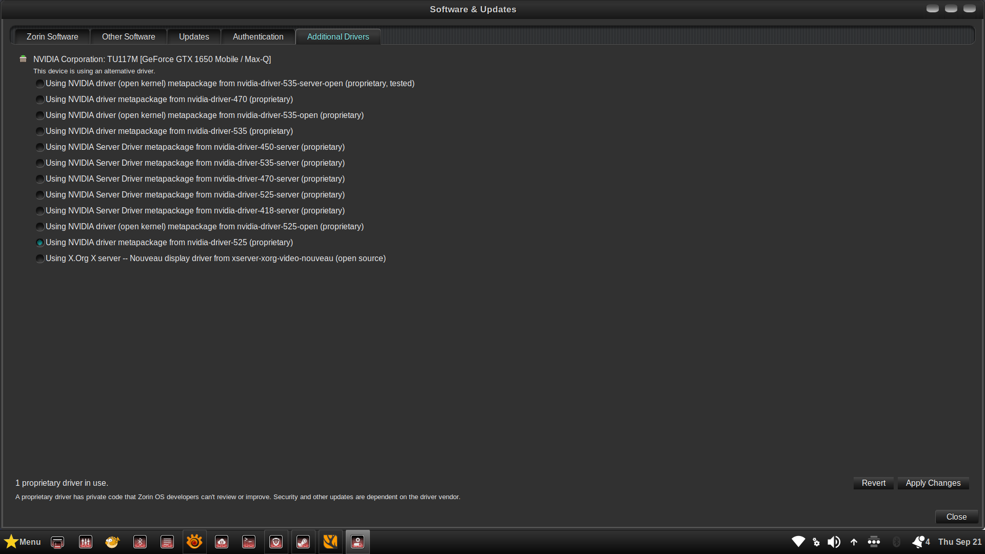

I'm now using NVIDIA driver metapackage from nvidia-driver-470 (proprietary) ..... I know there is 525 and 535 but not sure about those ....

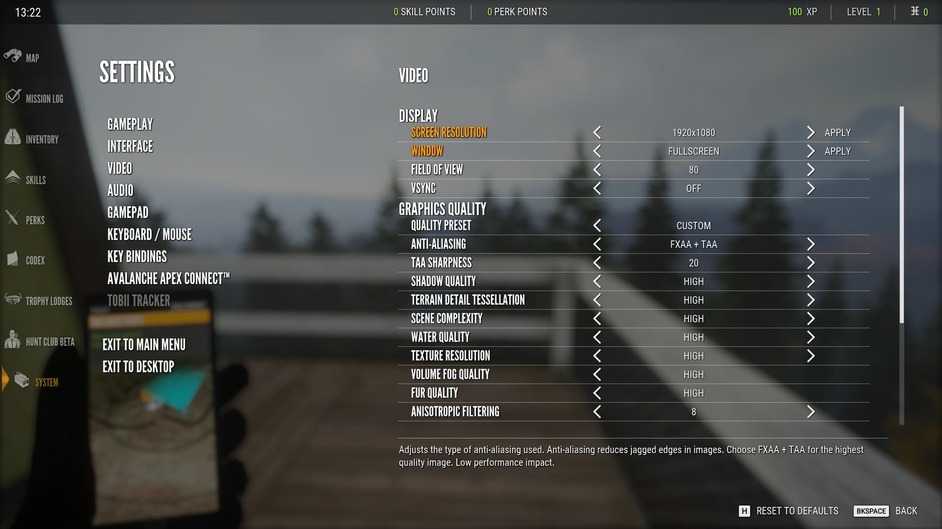

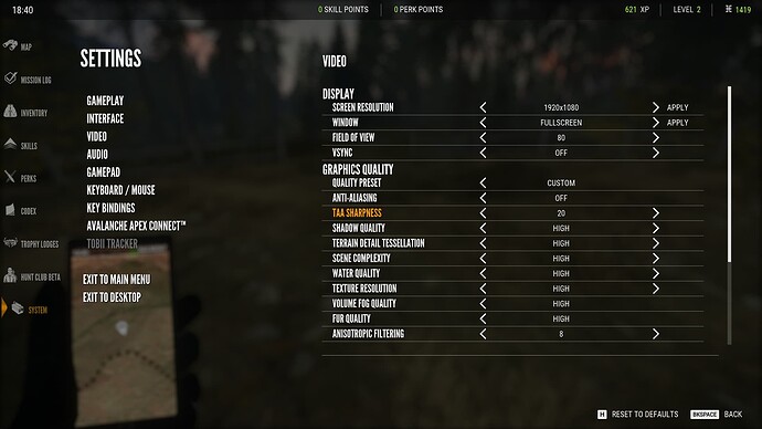

I'm running the game video like this right now .....
It is currently set to 'On Demand'
you have to log in X11 instead of wayland. This could also explain you low FPS. Wayland on Zorin is not up to date, so it's not wise to use.
Sorry it took so long to get back to you ..... in Performance Mode the game would not launch ..... so I went back to the previous setting and it launched but same problem as before ....... could this mean that the game is launching in Intel instead of NVIDIA ?????? ..... just curious .....

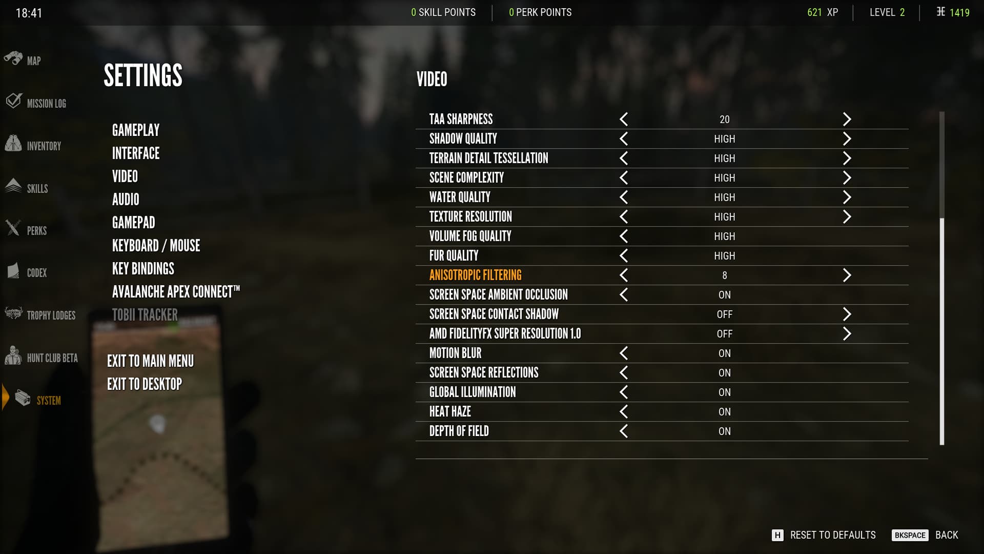

Huston we have a lift off ..... I left the combo in launch also turned off the Anti-Alising and everything is back on high ..... I can live with this .....

I just changed NVIDIA driver to (open kernel) metapackage from nvidia-driver-535-open (proprietary) ..... it didn't help ... ... why did I choose that one ???? ..... I have no idea I'm just grasping at straws right now .....

I checked the game spec's and I am defiantly with in the preferred range ......

If I could also add ..... I went back to NVIDIA 470 .... I also noticed my laptop started much quicker along with other desirable improvements ..... :+1:
