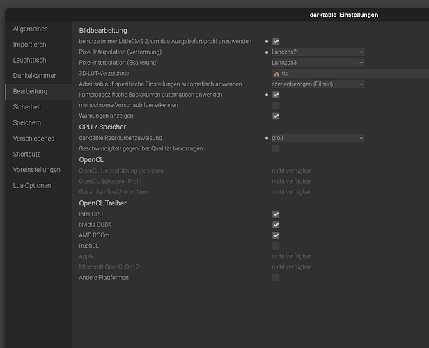

I use darktable in Zorin 17, and here is an option to run the programm with OpenCLSupport for faster rendering. I think all (opencl-)drivers are installed, but in darktable the opencl option is greyed out. How can I enable it?

I have an Intel Arc 770A, but in the darktable-settings seems a Intel Driver "installed"
But enabling OpenCL is greyed out
