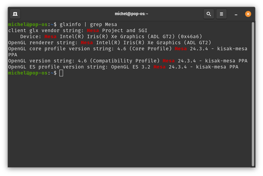

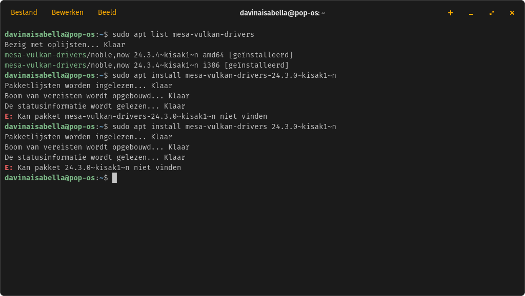

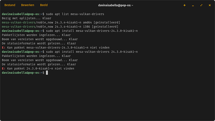

I really don't get it...what am i missing. This is just for testing purpose because i want to know how to downgrade a driver with a ppa like this.
24.3.0 -> amd64 build of mesa 24.3.0~kisak1~n : kisak-mesa fresh : kisak
Edit: No files to download ? so they get replaced by the latest version ?

No, the reason is i dont want older packages. I want to learn and understand if i can downgrade the mesa driver from the same ppa. They listed all versions but for some reason the packages are removed. So in other words when they upgrade the mesa driver they remove the older version. So if you have issues with the latest one….your screwed.

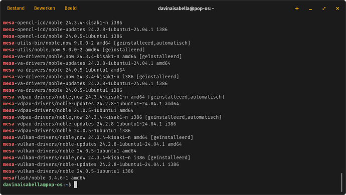

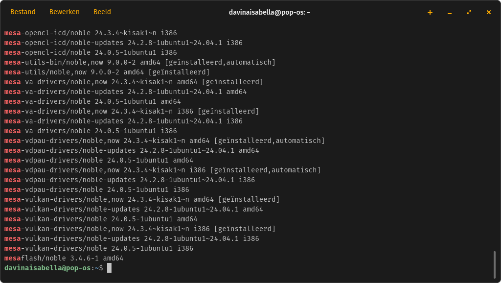

You notice the Tilde being used in the Kisak packages. The Tilde represents precedence, signifying that package is an earlier version.
Running apt list mesa produced no results, at all.
I needed to use
apt list --all-versions | grep mesa
This then listed the available earlier versions and the kisak versions. For example:
mesa-va-drivers/jammy 22.0.1-1ubuntu2 amd64
mesa-va-drivers/jammy 24.3.4~kisak1~j i386

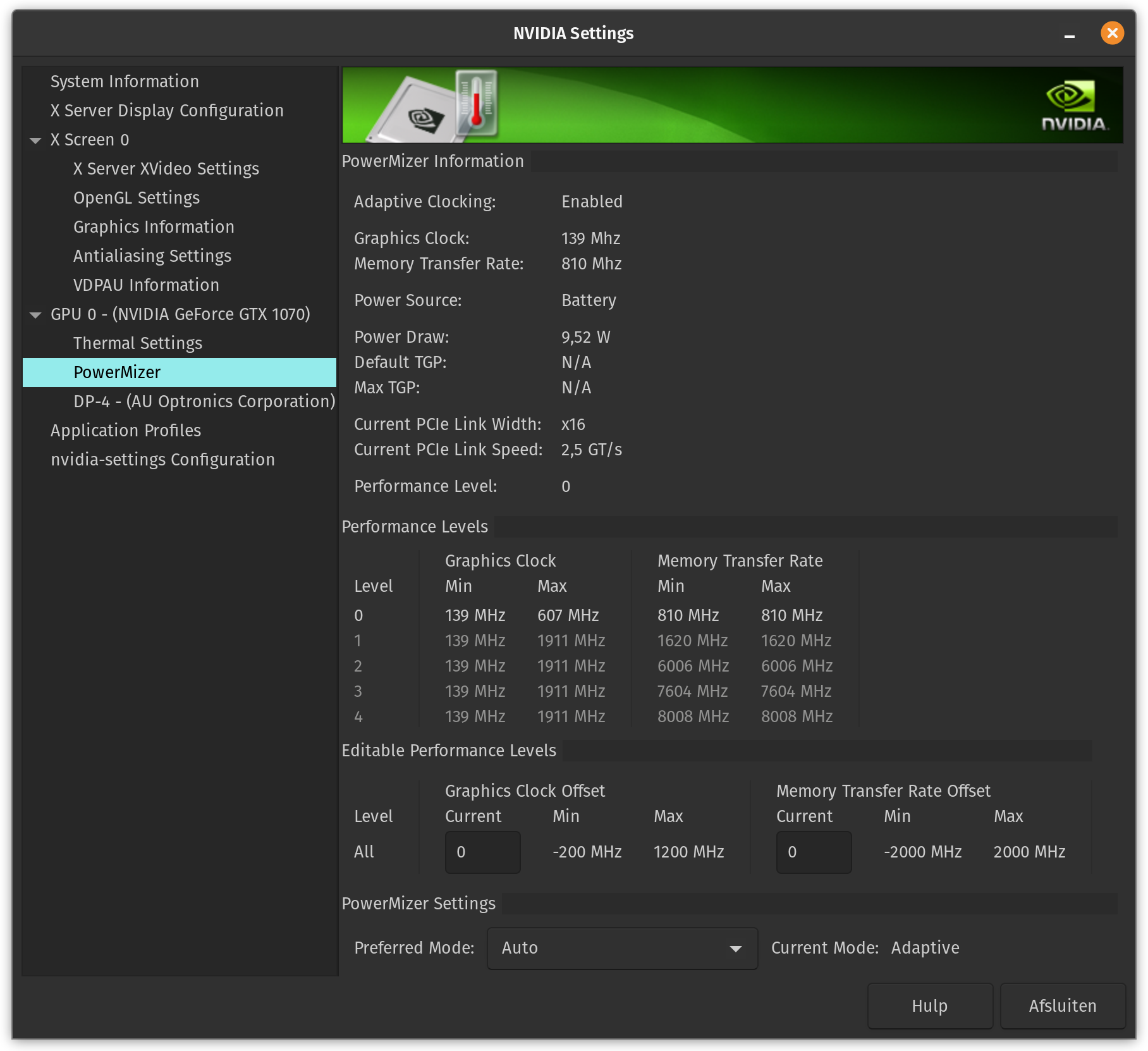

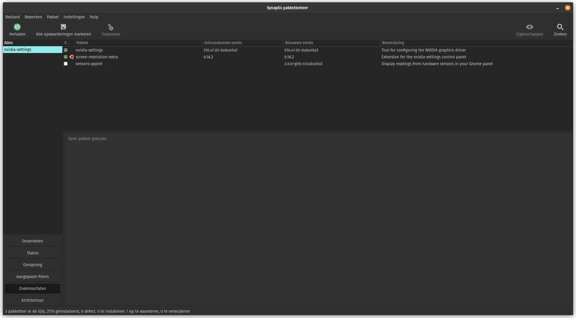

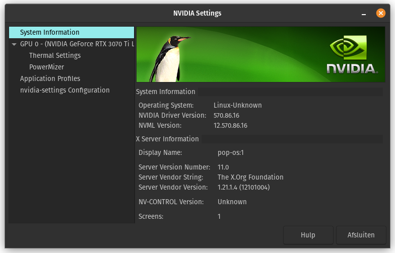

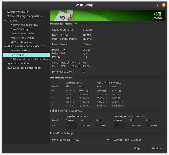

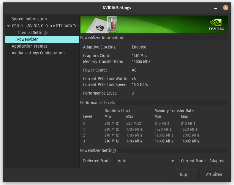

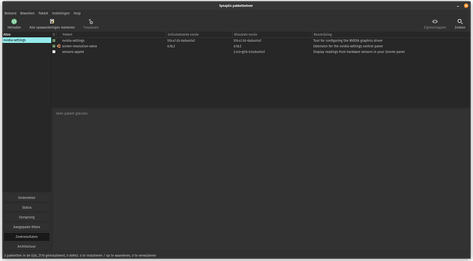

I also added the nvidia ppa from @Aravisian to check the nvidia install, also works fine. However i did notice the nvidia-settings is still using a old version. I will check this on my acer notebook if it has the same issue or not. On the acer i did a manual installation using the .run file from nvidia.
Edit: Checked the Acer notebook, can't really find what nvidia-settings it is using. I do know the latest driver did get stuff to overclock/downclock the gpu in nvidia settings. Mine is lacking from that feature (it's possible my notebook does not support it).
Acer Predator G9-793-71SJ: Nvidia settings with overclock/downclock settings
