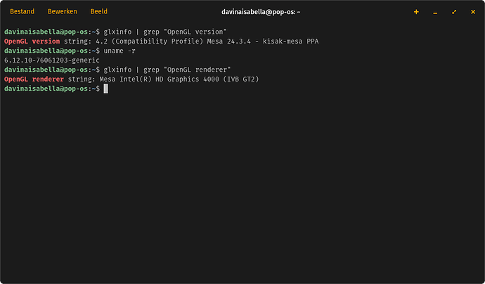

Is there a way to downgrade a mesa driver from kiska, i have now installed the latest version but is it possible to downgrade to a earlier version from kiska ? I cannot find any commands for this nor can i find anything in synaptic manager.

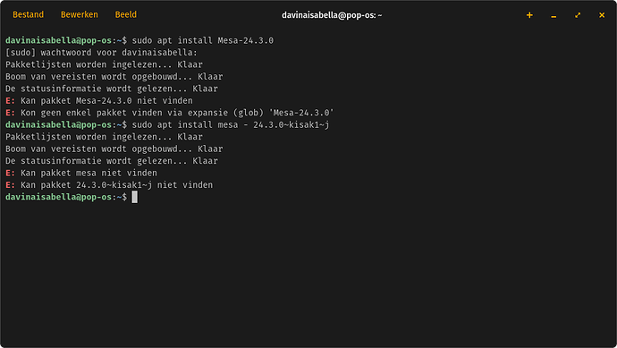

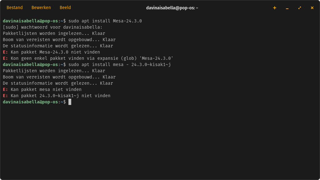

I get this

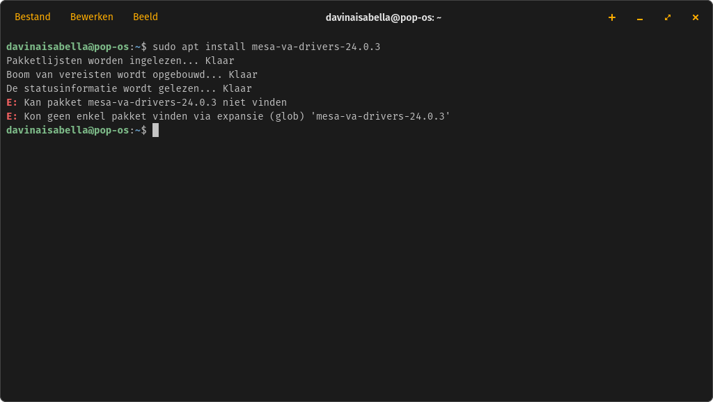

sudo apt install mesa-va-drivers-24.0.3
My apologies.
Mistook your post.
Already tried that too.

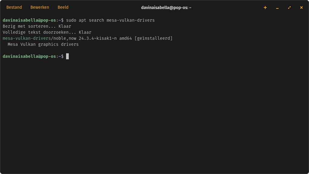

Have you used apt search to check the full version number?
You did?
It seems my second humor fell flat.
Only shows this
Odd. The earlier version is not sourced?
