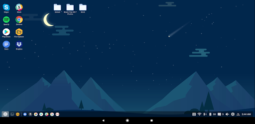

Here is a quick picture I took of my old Galaxy S6 running Zorin Lite with my Azenis Theme on it:
