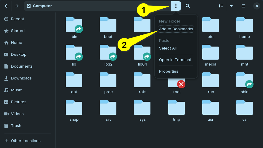

Actually, I had this question, how can I add mounted drive on sidebar?
I couldn't find any answer, most of them suggest installing Nemo FM, anyway I have an easy solution.
Go to computer / mnt (some devices go to media folder) and add your desire mounted devices as a folder to the bookmark.

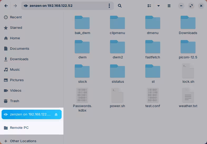

  2. Once the connection is established you will see both the bookmark and the actual connection:
    You can work around this by not using Nautilus (the file manager) to handle mounts, and going through the regular /etc/fstab/ configuration file. But this is a bit more involved, and less convenient.
Last but not least, in the bookmarks configuration file you can also specify the display name at the end of the line. This can be useful if you have more than one network drive with different purpose, since the IP address itself is not very telling:
nfs://192.168.122.52/home/zenzen/Public Remote PC
This bookmarks my network share from another computer (where my username is also "zenzen"), which is shared using the NFS protocol. If you were using FTP or SMB, that's what you'd use instead.

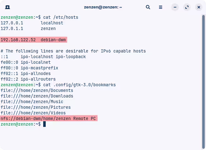

EDIT: Yes, you can use custom hostnames. If you already have a DNS resolver for your local network, or have your remote host hosted somewhere on the internet and with a domain name already set up, you don't need to make any changes. Otherwise, you need to tell your computer how to translate 192.168.122.52 (or whatever your IP for the remote host is) to the name that you want to use.
To do that, edit the file at /etc/hosts, and the bookmarks file accordingly to use the domain that you specified, like so:
I chose the domain name "debian-dwm" in this case. You can obviously choose what you want, but do not use spaces for this.

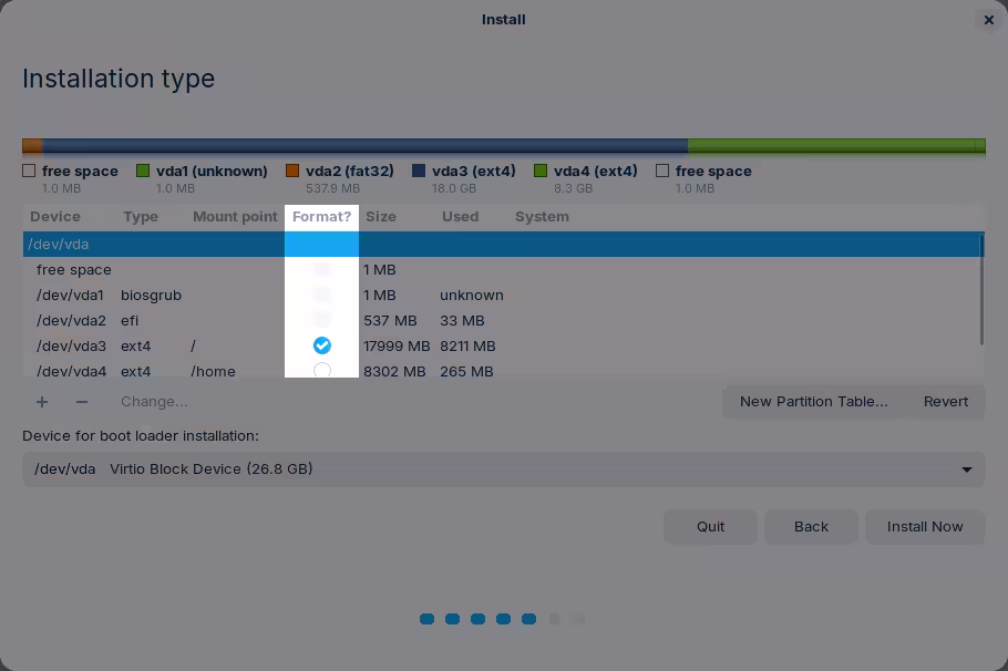

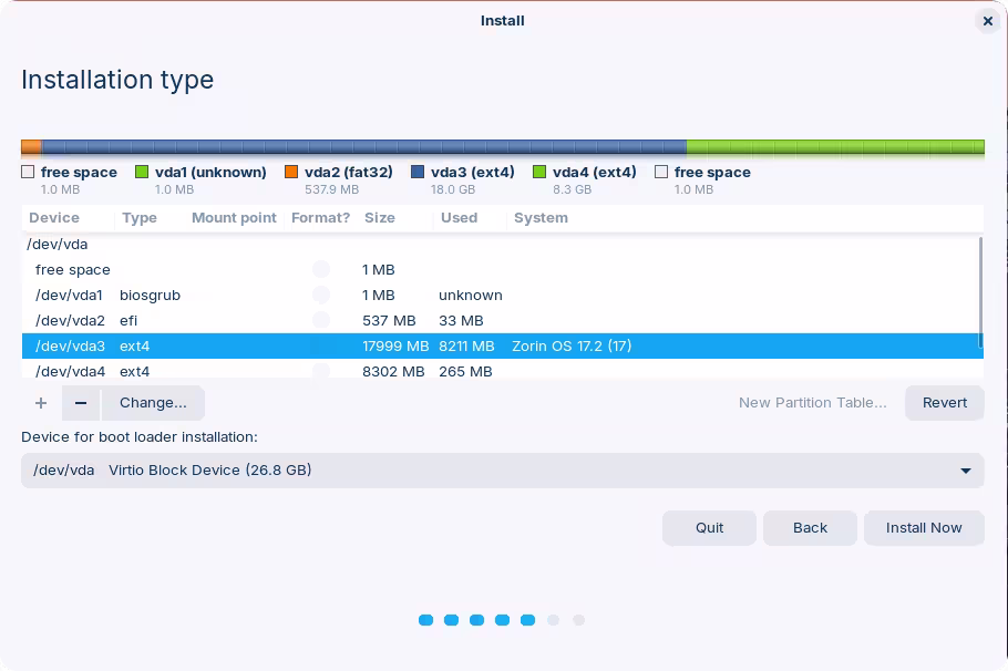

If you recall, during the installation of Zorin OS you are offered several options:
Erasing the entire disk would do exactly what it says, and "Something else" will take you to another screen where you can choose to modify the drive as you wish.
Here's an example of a drive with Zorin OS installed in one partition (/dev/vda3) and a dedicated home partition (/dev/vda4). To re-install Zorin OS I would select the root partition, click "Change" and fill in the details:
Choose whatever size you find appropriate for your use case, select EXT4 as the filesystem, check that "Format the partition" setting and, finally, enter "/" as the mount point.
Next, repeat the process for the home partition. This time, however, you will not check the "Format the partition" option, and enter "/home" as the mount point. What this will do is tell the installer that you want to use this partition, and it will set it up so that it's automatically mounted.
You should have something like this. Notice the tick on the "Format?" column:
These are the same steps that @swarfendor437 goes over in that other thread linked above, but I wanted to show you that it's possible to do this directly during the installation itself.

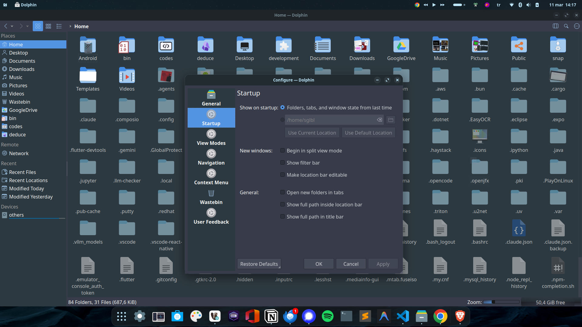

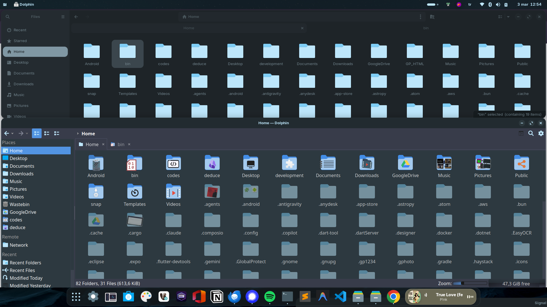

For other people who wants a solution with a different file manager:
I suggest dolphin.
Other advantages of it:
