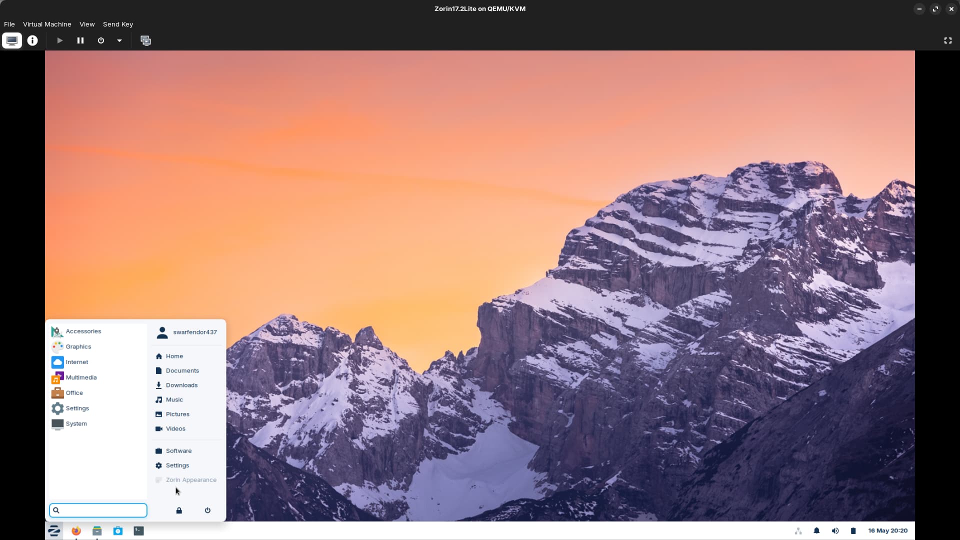

I downloaded Zorin 17.2 Lite and installed it as a VM using virt-manager in Zorin 17 Core. This leaves a greyed-out 'Zorin Appearance' in the menu but does not affect the menu that is the default with Zorin Lite. Initially you could click on the greyed out icon and label which launched an error message. I delved into the system and searched for Zorin Appearance - there is one folder left, 'Zorin_Appearance'. I had to cd .. to get down to _ pycache _ then rm . the contents before going back up one directory to rm those which means no more error message if any attempt to click on the greyed-out Zorin Appearance. I tried removing with Menu Libre - even installed Alacarte - ironically it listed Zorin Appearance but it was not checked which means it should not have appeared in the Menu but having said that Main Menu ('Alacarte') is a Gnome Menu Editor.

(Footnote: I did find that Zorin-Appearance.desktop was owned by root, I used chmod to take ownership, deleted it but it was still in the Menu!)

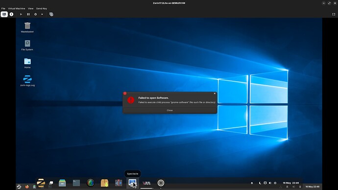

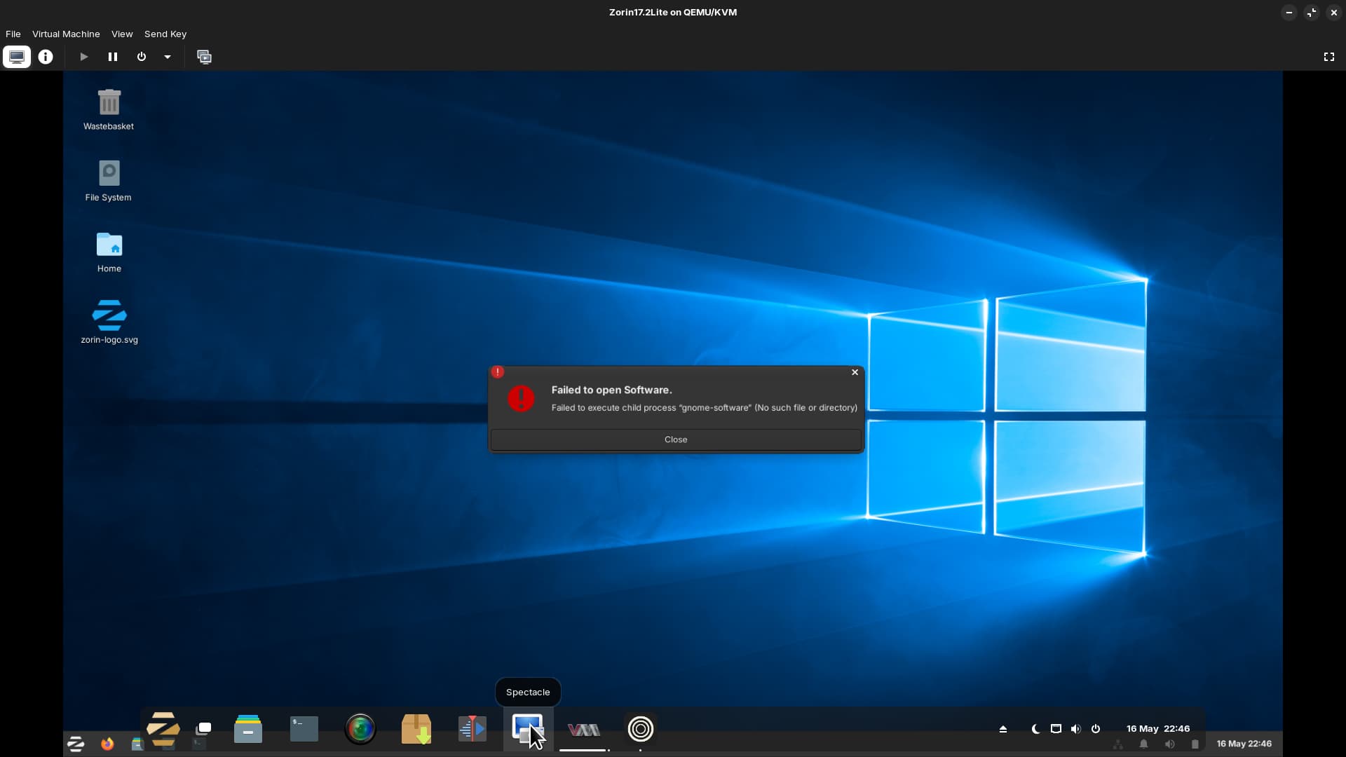

Ok, to get rid of 'Software', open a terminal and enter:
sudo apt-get purge gnome-software

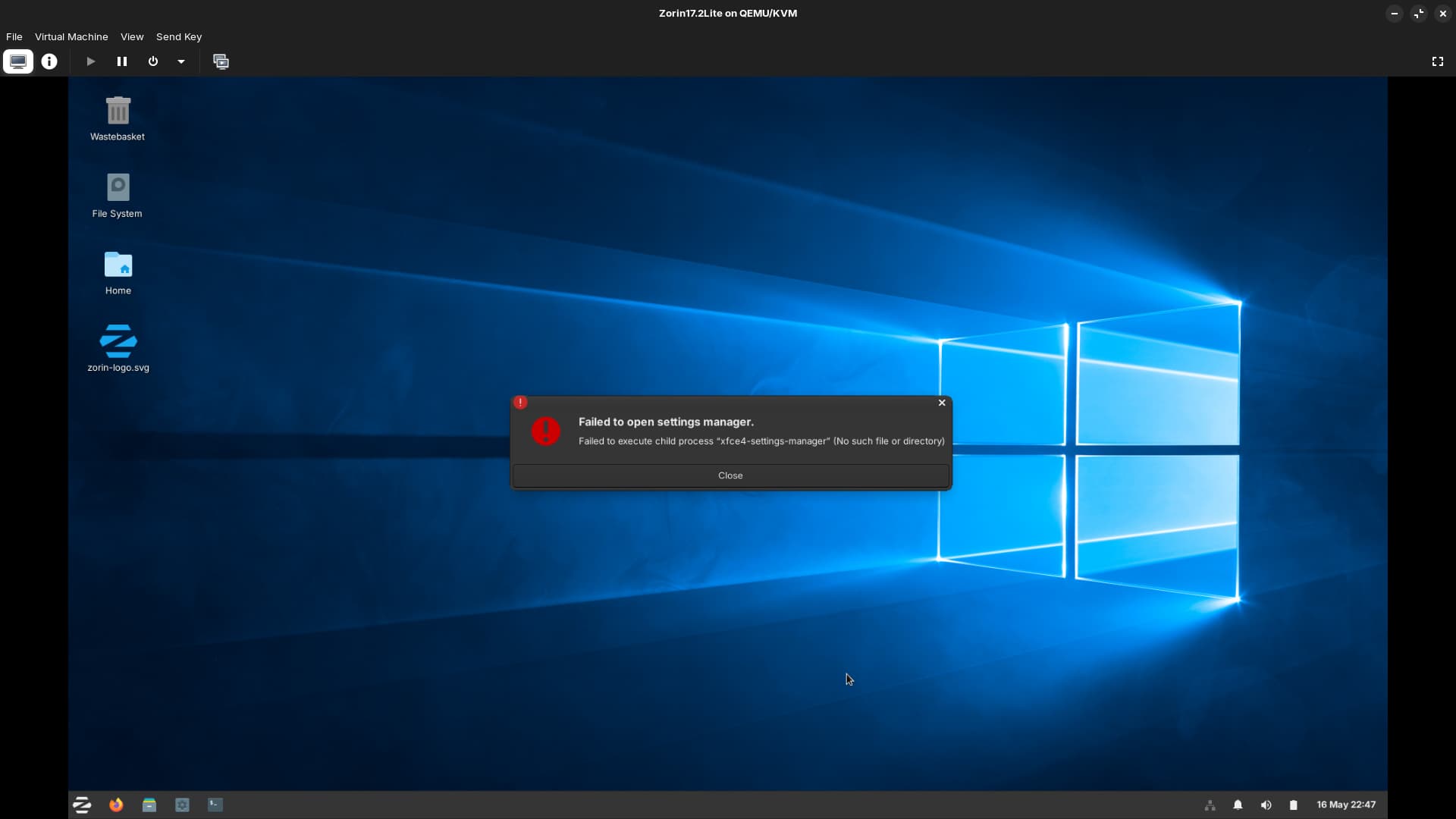

To get rid of 'Settings':
sudo apt-get purge xfce4-settings
Now, whilst it removes them, it does not remove them from the menu, but if they are clicked on they get error messages:
Software error message:
Settings error message:
However, removing Settings prevents you from shutting down!
And a force restart reveals that xfce has departed completely, leaving only Plasma!
Yes, these are direct links to the application in the menu, apparently.
