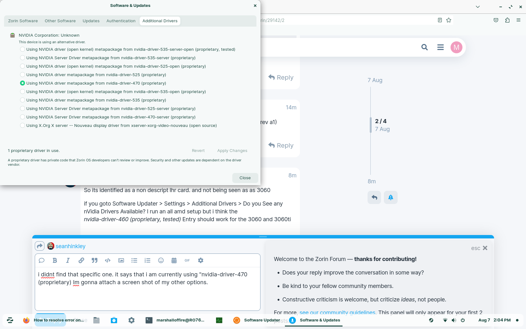

if you goto Software Updater > Settings > Additional Drivers > Do you See any nVidia Drivers Available? I run an all amd setup but i think the
nvidia-driver-460 (proprietary, tested) Entry should work for the 3060 and 3060ti
i didnt find that specific one. it says that i am currently using "nvidia-driver-470 (proprietary) Im gonna attach a screen shot of my other options.
470 is newer, and should work - i'm not sure why the card wasn't identified if the driver is loaded - But I have limited experience with nVidia cards.
