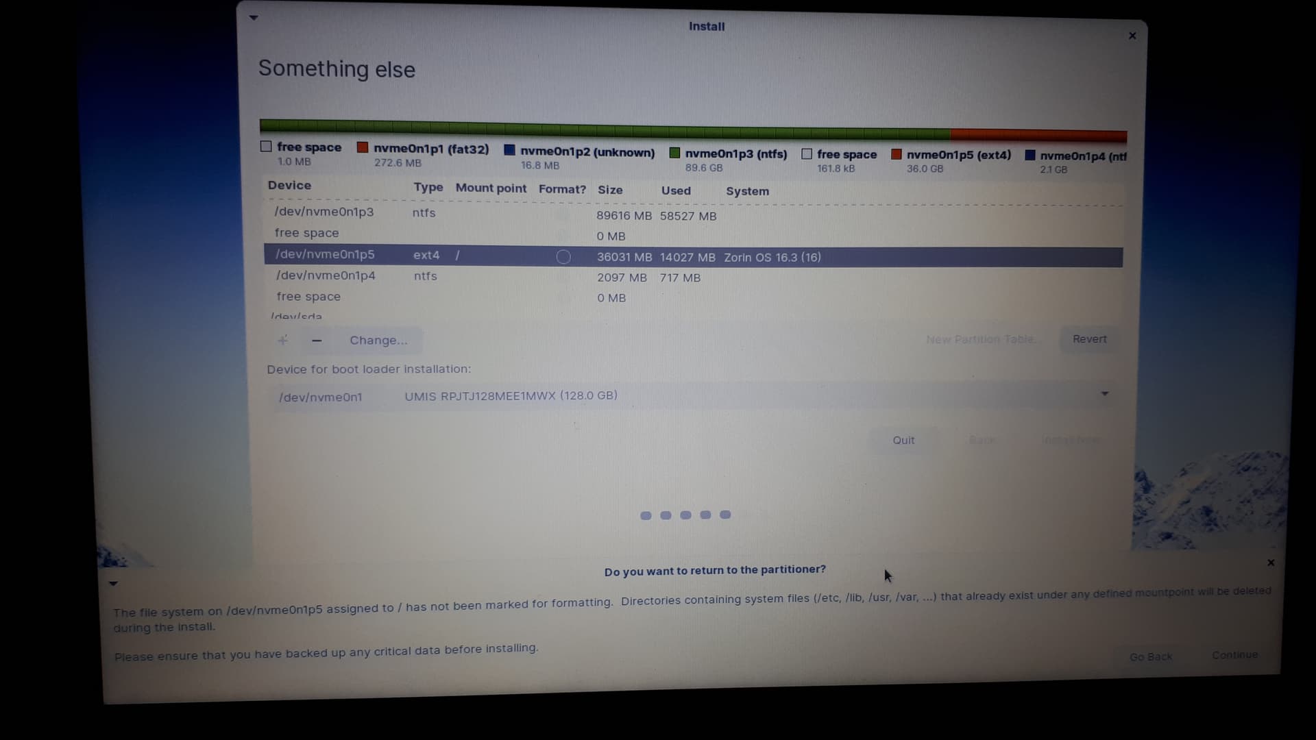

This will open the partition manager. Click on the ext4 partition (you can show a screenshot or screen photo if you need confirmation) that has Zorin on it.
Click the (-) icon on the toolbar.
That will delete the partition and list it as Free Space.
Now, click on the Free Space you just made and click the (+) icon on the toolbar. This will open a popover window to format that partition. Format it as ext4, primary, set the size if you want / need to do so. Set as at beginning. Be Sure to set the Mount point to /
Yes, I did click + etc. The radio button is visible (but unselected) after doing that.
Following the above steps, the partition first becomes free space, then (after clicking + etc) gets marked again as "Zorin OS 16.3 (16)"; selecting it, not clicking the "Format?" radio button and clicking "Install Now" results in the following message:
Do you want to return to the partitioner?
The file system on /dev/nvme0n1p5 has not been marked for formatting. Directories containing system files (/etc, /lib, /usr, /var, ...) that already exist under any defined mountpoint will be deleted during the install.
Please ensure that you have backed up any critical data before installing.
Go Back - Continue
I may not be picturing what you are describing correctly.
You are to format the partition - then proceed to install Zorin OS after formatting.
If you are seeing a radio button within that Popover window that sets the drive as primary, beginning of space, mount point as / and so on - then yes, select it.
You have that selected and you can see the (-) is clickable on the lower left (Next to the button marked "change"). You can see that the (+) is grayed out.
Click the (-) button.
Next, click on the same line that was the ext4 partition and now is Free Space. The (+) should now be clickable and not grayed out. Click the (+) button.
This will open the above mentioned popover window.
After turning it into free space and then doing the pop-up /ext4 / primary etc, it returns to saying "Zorin OS 16.3 (16)" the same as before the whole process.
Once I click OK, I get that partitioner window with the radio button deselected and if I click install now, the message asking if I want to return to the partitioner.
