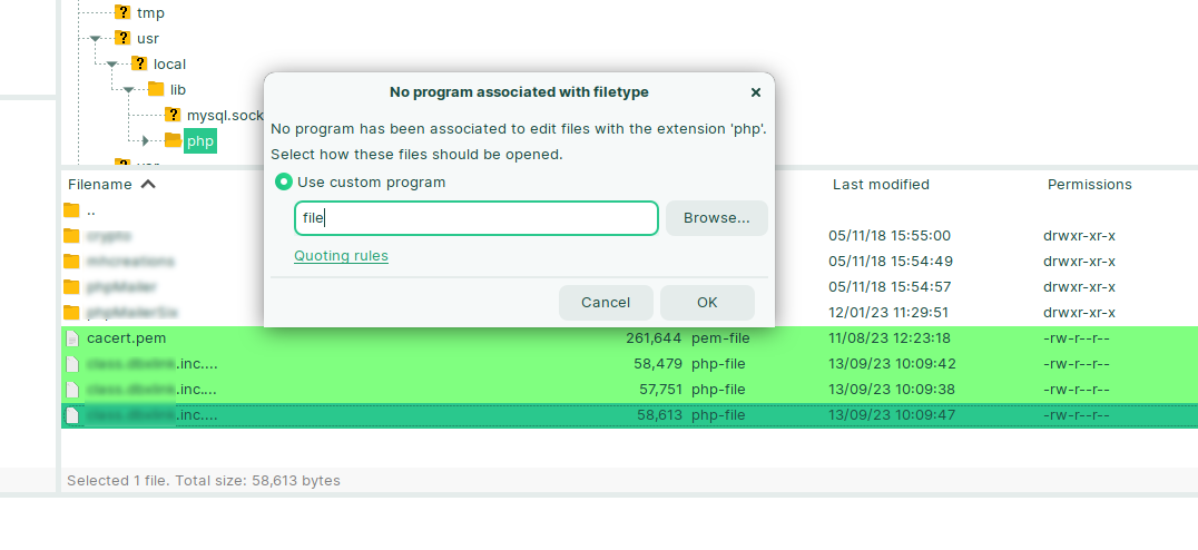

I have some times popup boxes telling me no default program is set to handle certain file types. This presents me sometimes with a box of standard choices (eg krita for graphical images) but sometimes no options are present.
How do I find currently installed apps on the Zorin OS file system to associate these file-types to?
Specific use request: I want to have my Filezilla SFTP explorer use the default "text editor" (gedit text editor 3.36.2) to open remote server files, but I can't find that editor program on the local OS..... where is it?
How do I associate these two in the dialog interface which is presented?

Ok, that's a fine big detailed instruction you've set out. Now how would I then be able to do what you have mentioned using the "browse" button as per the screenshot on my post?

Given the screenshot you showed, it looks like the "Browse" function is not showing you what you want.

However I can't "edit" them; the dialogue interface gives me a file system browser rather than any sort of app listing. This may be a Filezilla specific issue.
The same files that can be opened by Text Editor in the local disk on Filezilla can not be opened in this way for the remote files (as per the screenshot) the only option being the "browse" button as per the screen shot.
I am trying to find what the correct file system command would be using this interface to open a (in this case PHP) file with the default Text Editor.
Any help appreciated. Thanks!

It is a remote drive with Filezilla having complete root access. Access / permission on the remote drive is not an issue.
I perceive the issue here is that filezilla for better or worse is expecting the filepath to the deb package. I will dig that out and try that, thanks for the pointer in this respect.
You can find the full path (meaning the exact location in the file system) where programs live by running the command which <name_of_command_or_program. For example if you wanted to use VSCodium you would run
which codium
Yes, a bit confusing since the "marketing" name is VSCodium but the installed file is called simply called "codium". Use the commands listed by Aravisian above to find the exact name that you need. In this case, it would return something like /usr/bin/codium which is what I'd enter in there.
