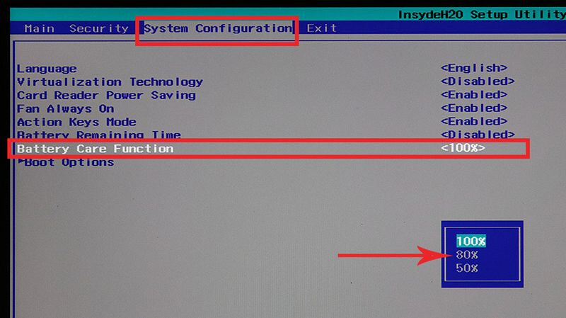

In some BIOS you can set the charging level for battery. So you could check first if this is possible on your system.
Maybe this site can help you:
Here is the mentioned gnome extension you could try:
With the app TLP (it is a terminal program) you can also configure battery levels.
Correct!
Additionally, if this Gnome extension is compatible for the OS & your computer, you can also use it, to limit the charge level of your battery as well...
