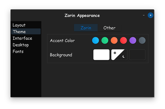

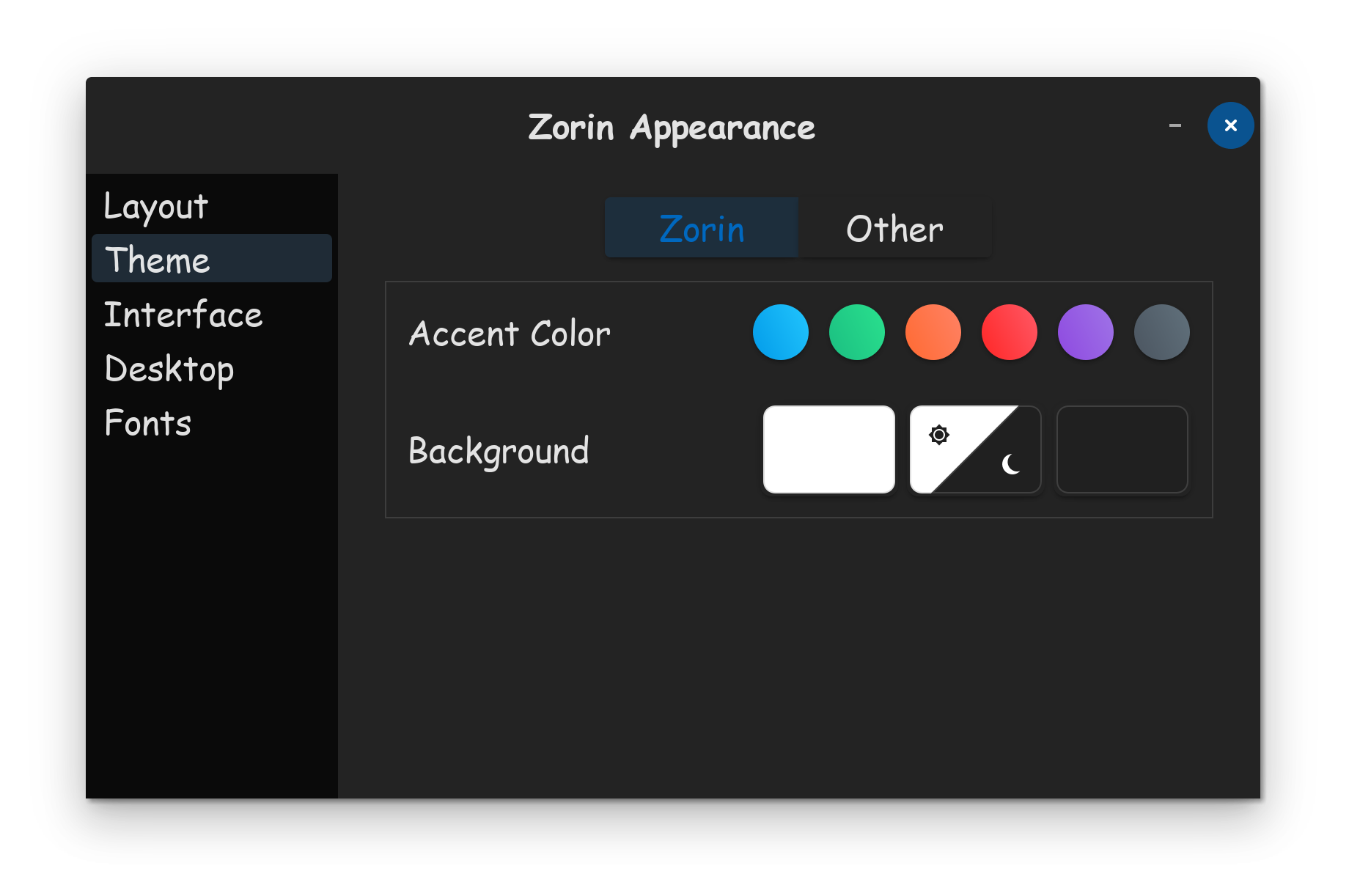

Okay, I found out when I modify the user-theme extension and additional set the theme with the gsettings it does change the apps I need and performs a clean theme switch.
So the working version is:

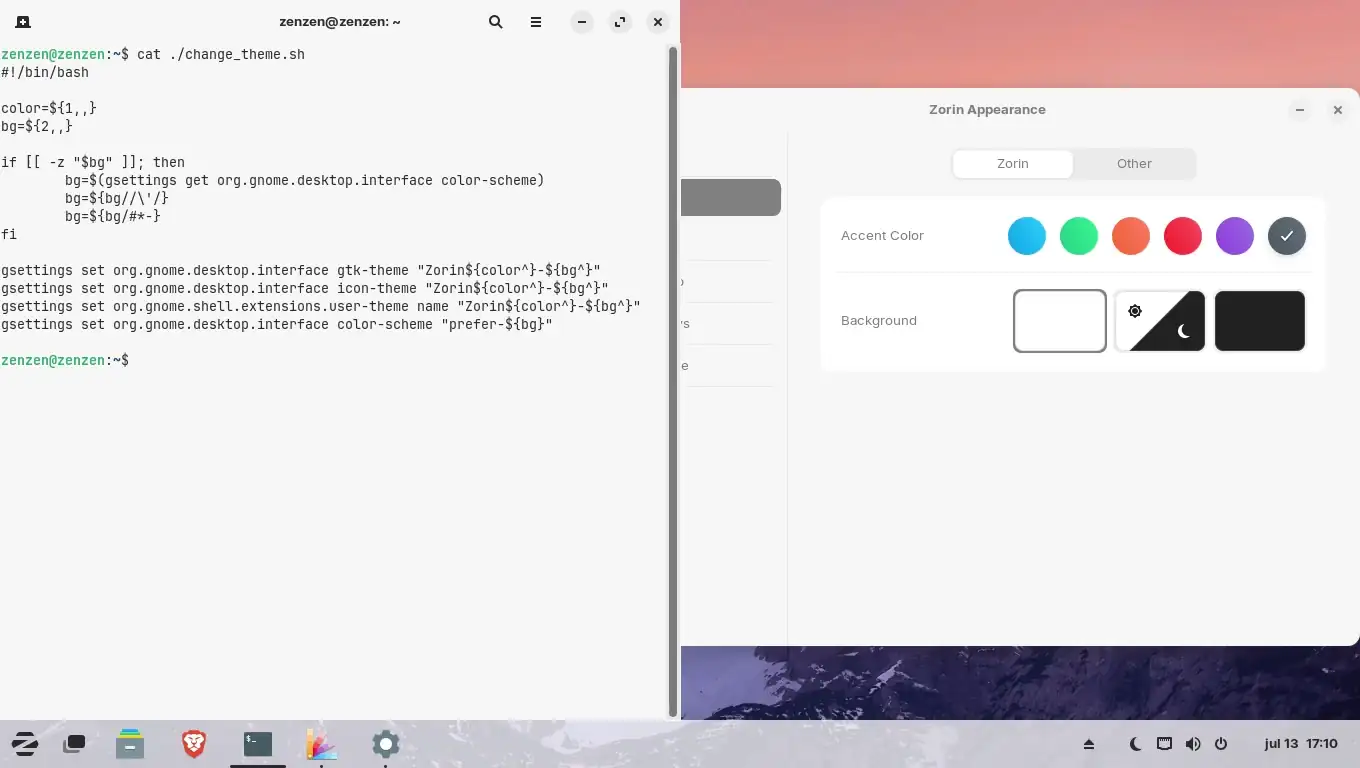

What do you mean? This seems to work fine for me. I wrote a little script to test this quickly:
sr1
#!/bin/bash
color=${1,,}
bg=${2,,}
if [[ -z "$bg" ]]; then
	bg=$(gsettings get org.gnome.desktop.interface color-scheme)
	bg=${bg//\'/}
	bg=${bg/#*-}
fi
gsettings set org.gnome.desktop.interface gtk-theme "Zorin${color^}-${bg^}"
gsettings set org.gnome.desktop.interface icon-theme "Zorin${color^}-${bg^}"
gsettings set org.gnome.shell.extensions.user-theme name "Zorin${color^}-${bg^}"
gsettings set org.gnome.desktop.interface color-scheme "prefer-${bg}"

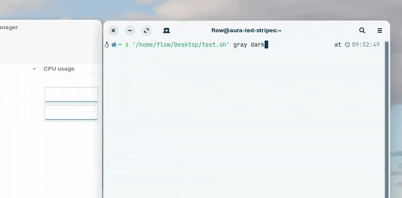

Using your script:
#! /bin/bash
color=${1,,}
bg=${2,,}
	bg=${bg//\'/}
	bg=${bg/#*-}
fi
Switching from light blue > dark gray, the script does not color all UI (example: virt-manager gui):
I think the next command in the sequence is overriding the settings of the previous command.
