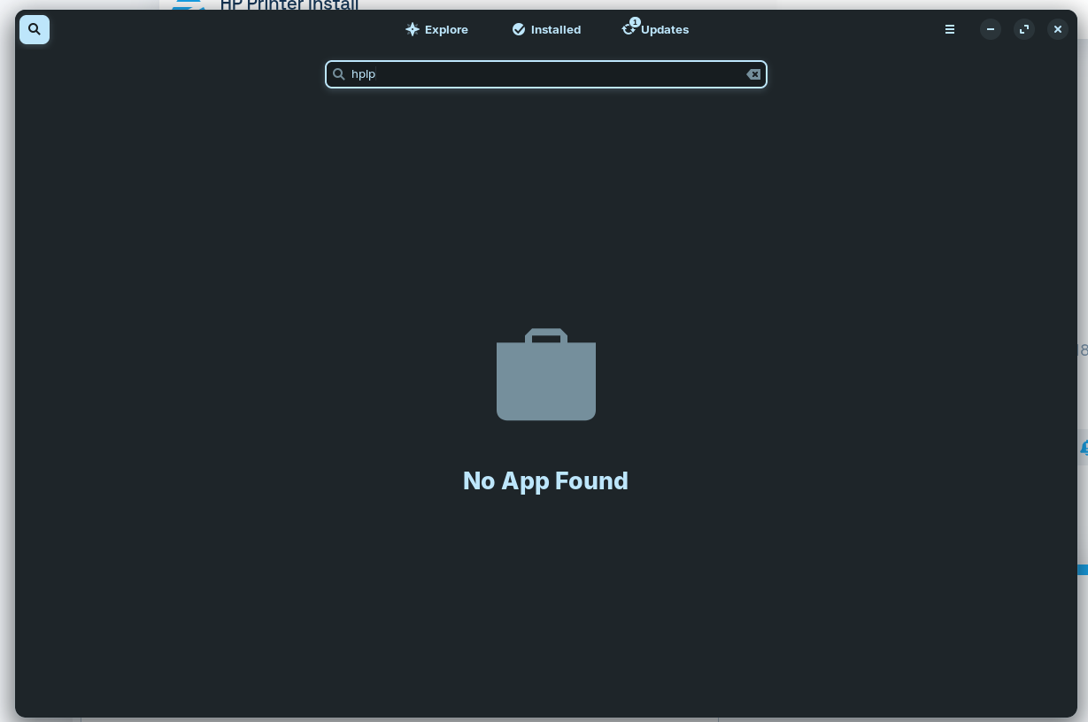

How do you install an HP Color Laser Jet CM1312nfi MFP for printing and scanning functions? Thanks.
Make sure the HPLIP driver is installed. It can be installed via the software store.

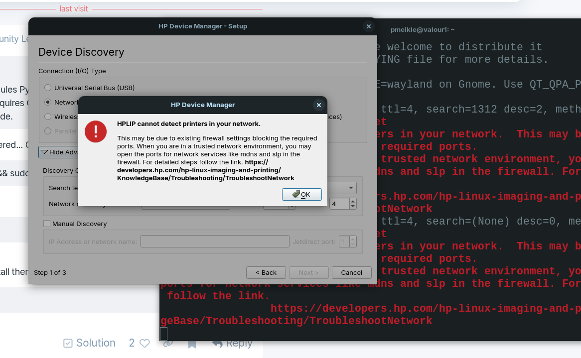

hp-setup query output below:
HP Linux Imaging and Printing System (ver. 3.21.12)
Printer/Fax Setup Utility ver. 9.0
Copyright (c) 2001-18 HP Development Company, LP
This software comes with ABSOLUTELY NO WARRANTY.
This is free software, and you are welcome to distribute it
under certain conditions. See COPYING file for more details.
warning: GUI Modules PyQt4 and PyQt5 are not installed
error: hp-setup requires GUI support (try running with --qt3). Also, try using interactive (-i) mode.
You can try as it offered... Or you can install the modules with
sudo apt update && sudo apt install python3-pyqt5
Then running
hp-setup
again.

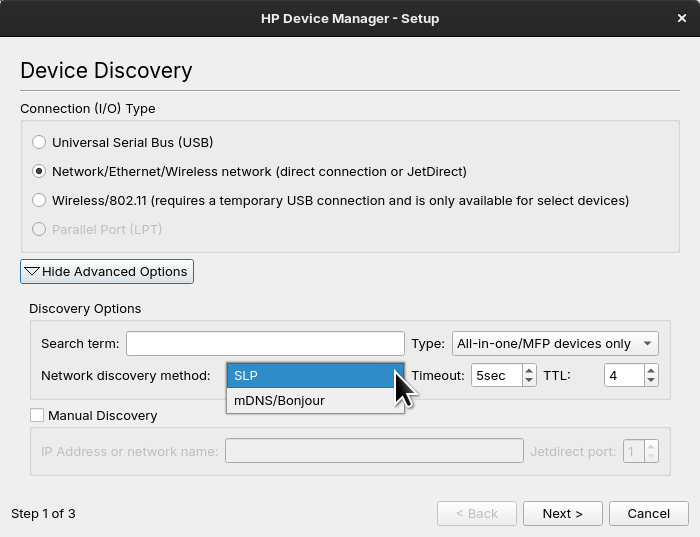

If you opt to not install them, try
hp-setup --qt3
I didn't know the OP had missing libraries, this could explain the difficulty. I just assumed the HPLIP driver was not installed. Hopefully, after the OP installs the missing libraries, they will be able to setup their printer.
For auto discovery, make sure printer is on, and physically connected. (USB is best here)
When I set my printer up, I had to do a manual setup, because I have my printer connected to an ethernet switch, using an ethernet cable, & the switch connects to the router. I manually entered the printers IP address.

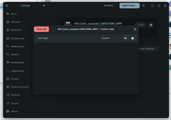

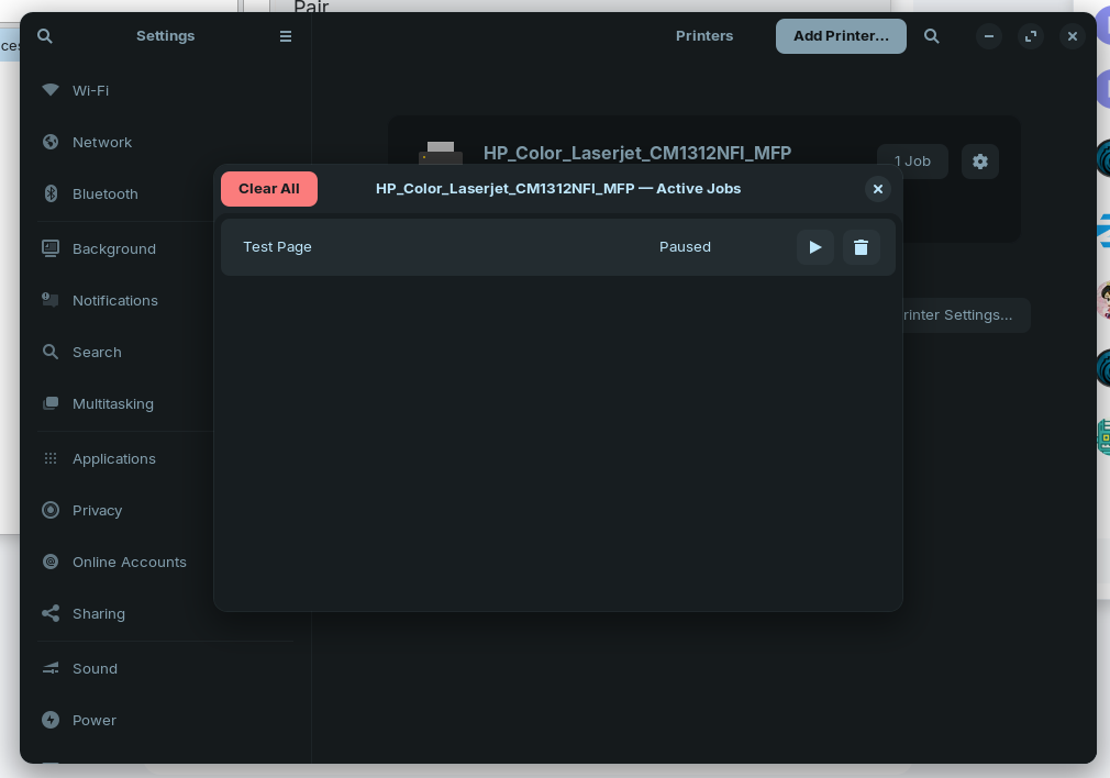

Power cycle the printer, Pull the plug, wait a couple minutes, then plug it back in. Also cancel the print job before you do that. Then restart your computer as well. Now try to make the test print again. If you have the correct driver installed, thats all I can think of for now.
