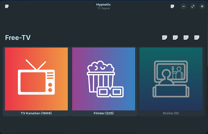

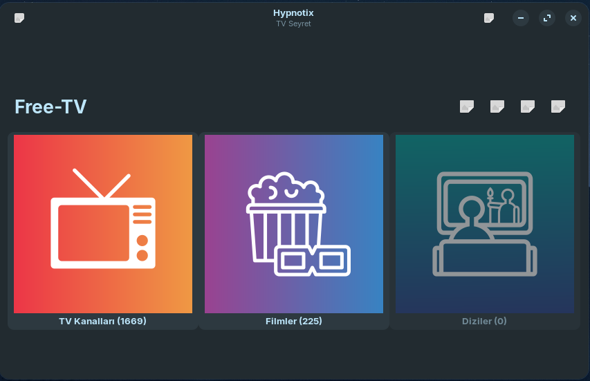

Hypnotix icon problems
How can I fix this?

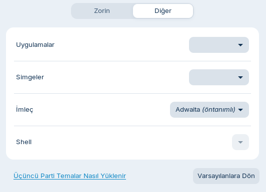

Are you using custom icons?
default is selected

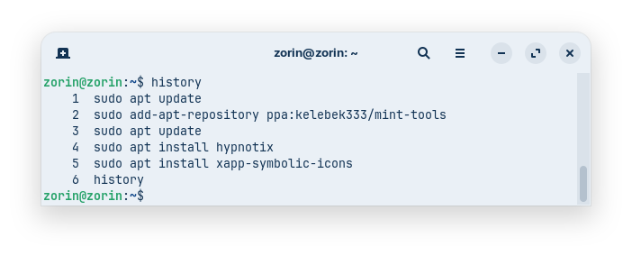

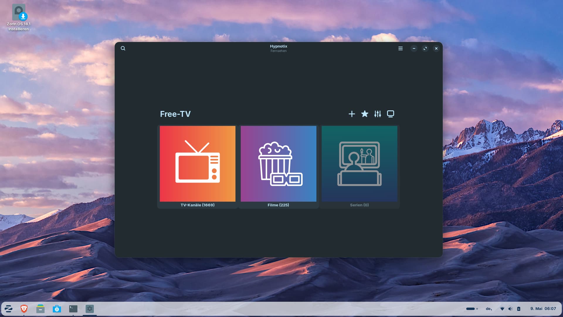

I tested it in a Zorin 18.1 Core live session with the kelebek333 ppa for the mint tools and installed hypnotix. I got the same icon error as you. Then I installed the package xapp-symbolic-icons and the problem was solved:
