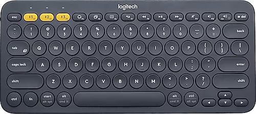

I bought Coverzone Mini v5.0 USB Bluetooth Dongle 5.0 Bluetooth. It works great on Windows. It automatically starts when i reboot Windows. But it doesn't start automatically when using zorin os. I have to take it out and put it back in once. I have to turn on this bluetooth dongle. Because I have a Logitech K380 bluetooth keyboard. I am very upset that I can't use this keyboard when I switch to Zorin OS. Does anyone have any suggestions for a solution?

I don't have a bluettoh connection on desktop. So i need to use this dongle. After some effort, I managed to achieve something. The computer recognized the Bluetooth keyboard and it worked. The computer does not automatically recognize the dongle that is plugged in when it is turned on. However, every time I turn on the computer, I have to remove the Bluetooth dongle and plug it back in. It is not very practical to use it like this. So I completely removed the Bluetooth dongle from the system. Of course, the keyboard too... :frowning:
Does the Keyboard not offer to connect with Cable? So, you could at least use it.
It is Logitech K380 keyboard. It doesn't have a cable option.

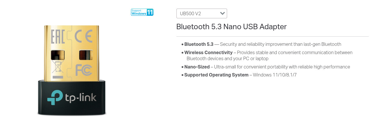

Now i read a comment on a forum and decided to change my bluetooth dongle. I ordered tp-link ub500.
Brave A.I. search engine via Mojeek search engine comes back with:
Linux Logitech K380 Support
The Logitech K380 Bluetooth keyboard is generally supported on Linux, but it may require some troubleshooting to get it working properly. Users have reported issues with pairing and connecting the keyboard, which can often be resolved by using the bluetoothctl command-line tool to manually pair the device.
To pair the keyboard, you can use the following steps:
  1. Ensure your keyboard is in pairing mode by pressing and holding the Easy-Switch button until the LED starts blinking.
  2. Open a terminal and run bluetoothctl .
  3. Use the pair command followed by the device address to initiate pairing.
For example, if the device address is 34:88:5D:EF:19:51 , you would run:
pair 34:88:5D:EF:19:51
After pairing, you may need to trust the device with the trust command:
trust 34:88:5D:EF:19:51
Some users have also found it helpful to reboot their system after pairing to ensure the keyboard works correctly.
Additionally, there are reports that the keyboard may not work out of the box on some Linux distributions, and users have had to manually map function keys using third-party software like k380-function-keys-conf .
Despite these challenges, many users have successfully used the Logitech K380 with Linux, including Ubuntu and Manjaro."

I solved my problem by buying another bluetooth dongle. It seems to be working fine for now. The bluetooth dongle I bought is TP-Link UB500.
