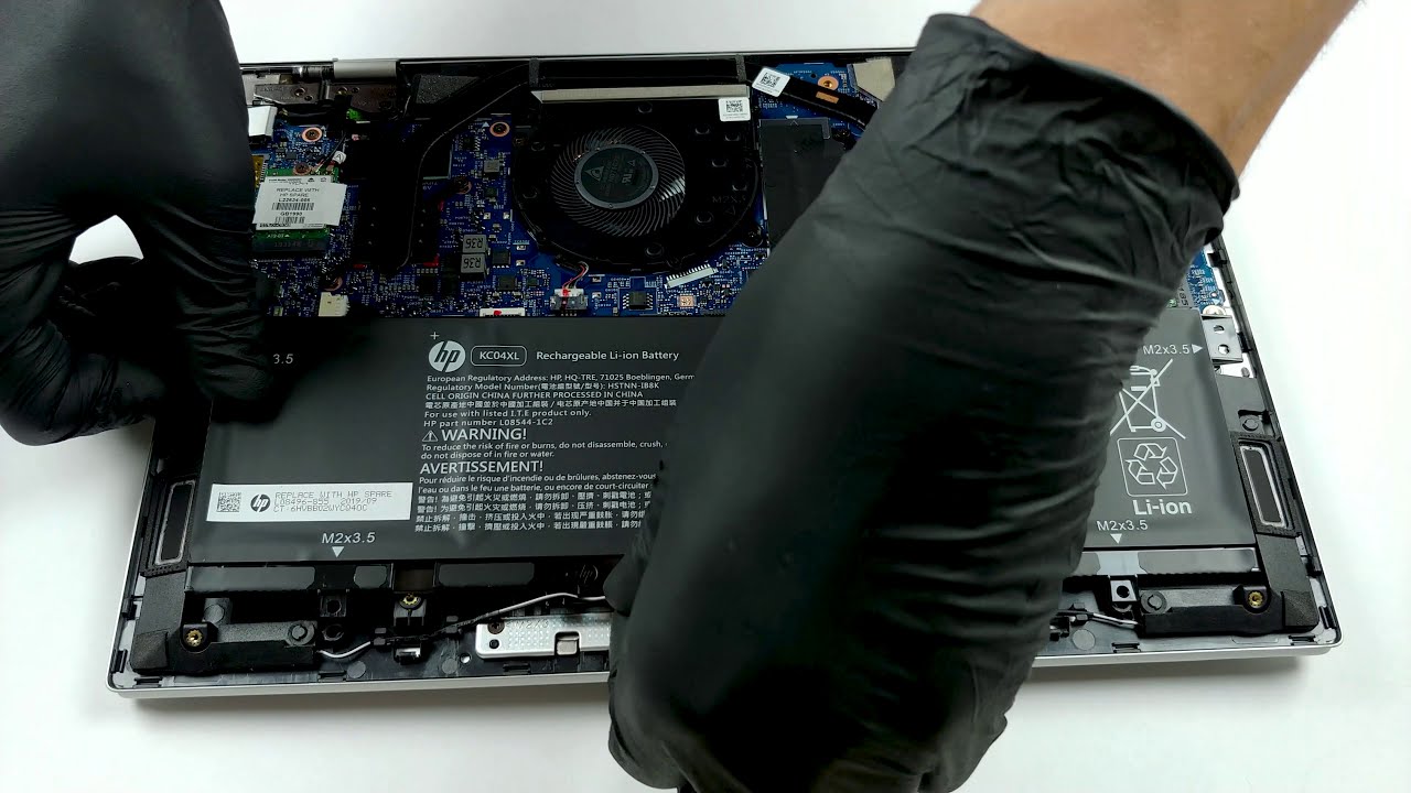

Ok, there's not much we can do with loading kernel modules... I'm now investigating whether the SMBus is kicking the battery off the bus (which it would do if the chip on the battery was malfunctioning and holding the SMBus low for an extended period... longer than 25 ms), or if the battery is simply communicating too slowly and the SMBus times out trying to communicate with it. So I'm attempting to find a way to increase SMBus timeout first. If that doesn't work, you'd have to find someone with an identical laptop and swap batteries to see if their battery works in your machine. If their battery doesn't work, either, that pretty much eliminates a bad SMBus chip on your battery.

I can see replacing your battery will be fun!
