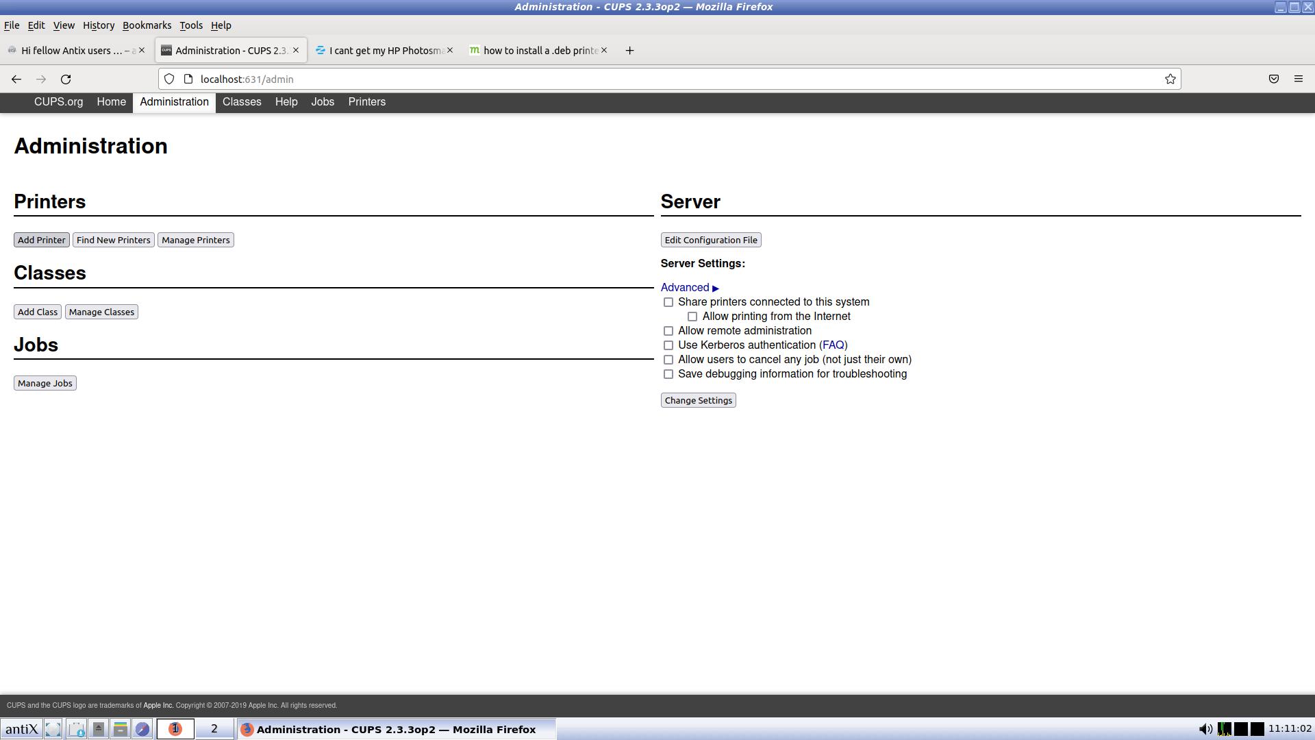

Thanks, nothing shows up under administration:
