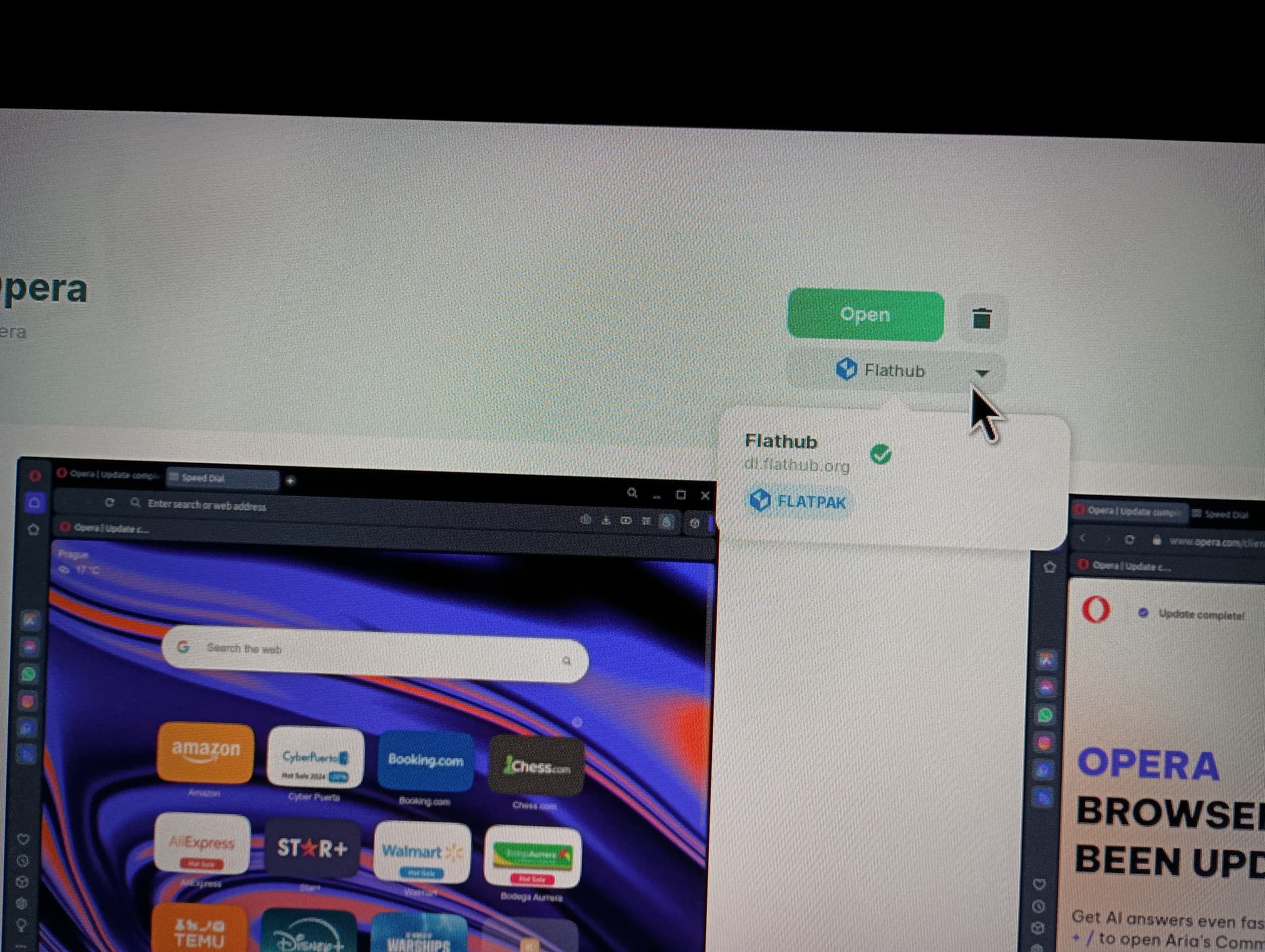

Okay, I'm now a bit irritated. When You open the Software Store and You go to the Opera Software Site, You have there at the right side a Dropdown Menu. Click on it and make a Picture. It shows every Package Option and what is installed. Post this Picture here please. You can find the Dropdown Menu under the Install/Uninstall Button.
I am not sure this is what you were directing me to do, not sure what relvace this is either when I did the physical information in my previous post.
BTW - the zorin snap photo tool would not operate with the software app open like this -

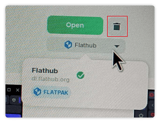

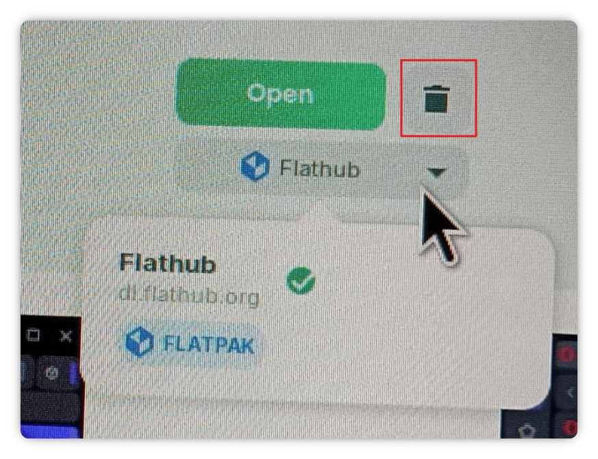

Okay, here are no other packages shown . Do you have a second entry in gnome software for opera browser or is that the only one?
Yes, this is what I have meant. That show that the Flatpak Version is still installed. When You now would click on the Trash Icon above, it would get uninstalled.
Before You do that: Do You still have 2 Entries now or not?

So, You want remove the Flatpak Version if I understand that correctly. Then, it should be enough to click on the Trash Icon to remove it:
