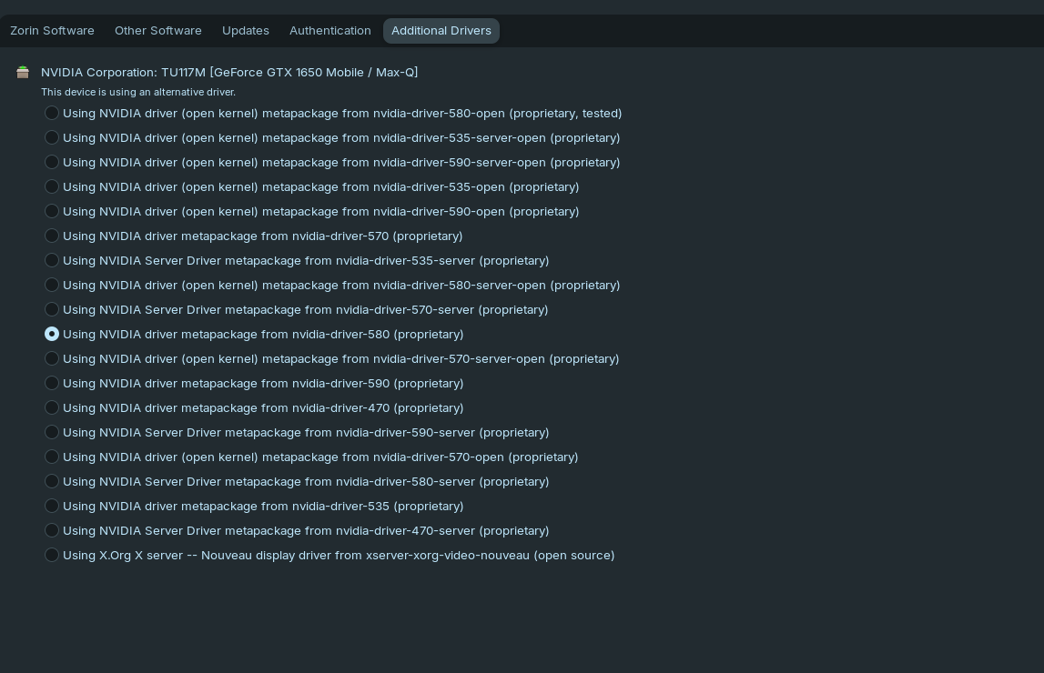

nvidia driver i try 590 580 570 same problem i have only zorin os
Did You used the ''Additional Drivers'' Tab in Software & Updates to switch the Drivers?
i use the 570 server one it works fine so basicly the next driver up in that list
Okay, so You used that. I would suggest to uninstall and then install again the Driver over the Terminal and see if that helps.

before i use 580 i have low fps
what do you think for 550 or 535
You can try these older Drivers to see if You get better FPS. But I've read here that there could be an Issues when installing the 550 Driver. When You use the apt install Command for it, look what Packages are getting installed. It could be that You see the Packages for 580. Please control that.

565 doesn't exist but when You mean 595, You go the same Steps like written here:
but You replace both 580 in the last Command with 595
