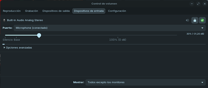

Hi!! thanks for answering. I uninstalled the flathub version of pavucontrol and reinstalled via terminal as you told me to. I navigated into the input devices option and my headset micro its already selected, but it doesn't works in the game. The ouput devices option only shows the devices like speakers and the headset itself but no micro.

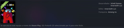

Hi, thank you for your help. I downloaded the lastest version of proton GE via Proton up-qt:
And i set it in the compatibility options of the game:

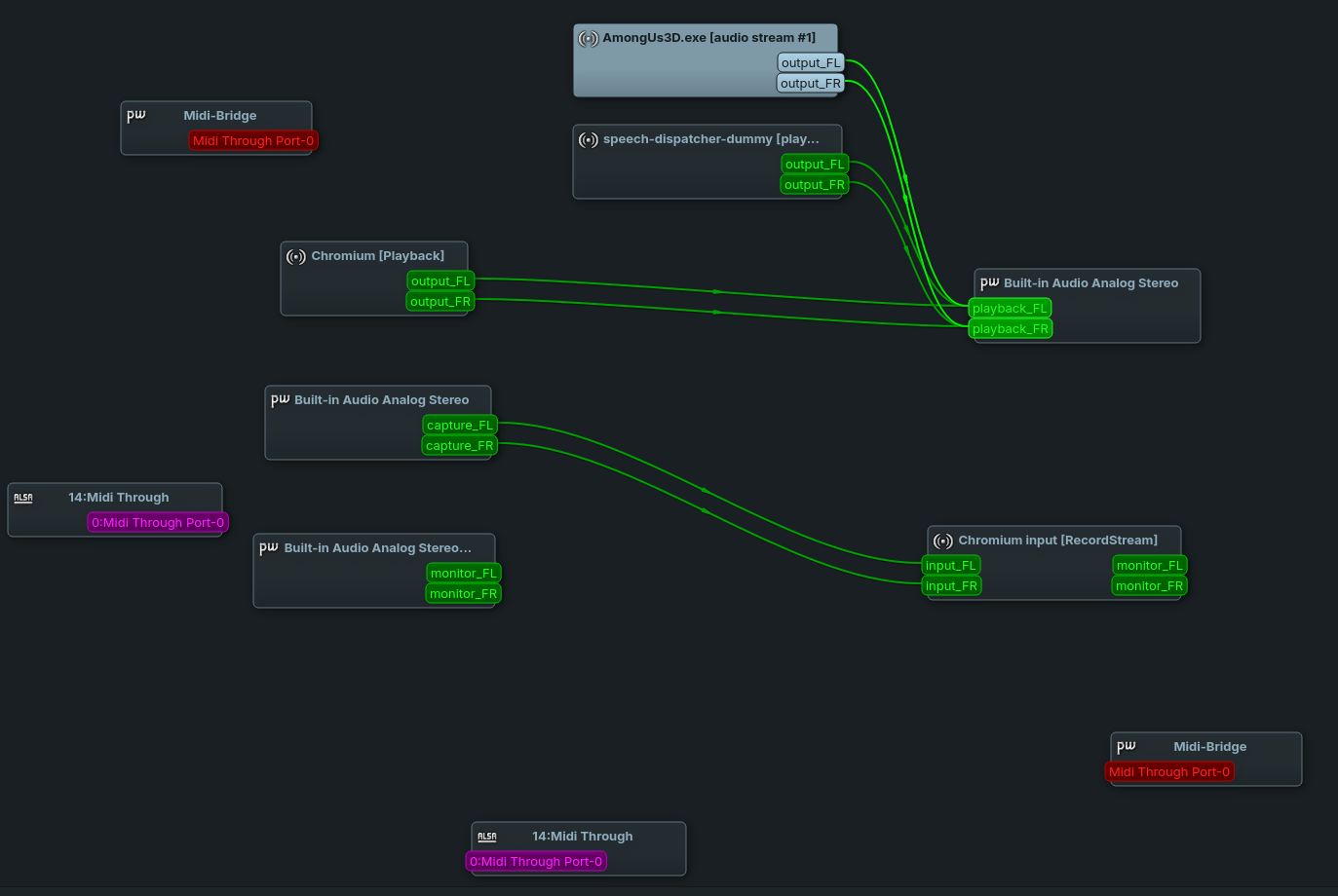

I was monitoring the audio bridging via qpwgraph, and this is what it shows:
It appears that the game doesn't have any form of input and only output options available in the graph.

You have set the proton version globally, but you should be aware that in some cases Steam decides that they know better and choose a version that they believe is best. If you click the Information tab on an installed game, it should say somewhere something like ;
Game will run with insert version here of proton
If that's the case, you need to go to the properties of the specific game and change it manually to the version you want.

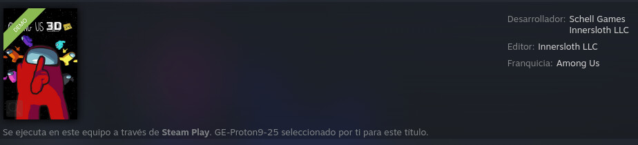

I checked the proton version that the game is using and it's the GE one:

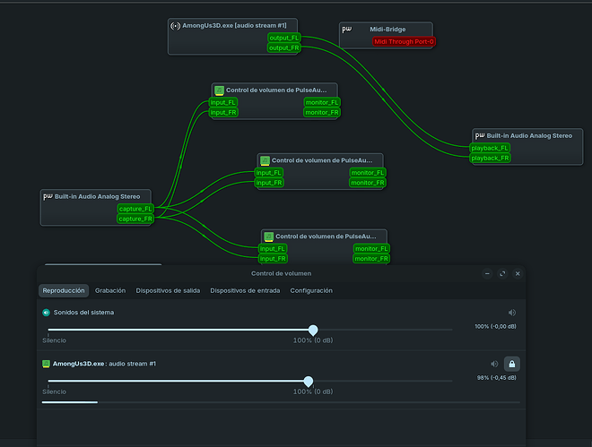

Hello, i am having the same issue, i was reading this forum and following every instructions that all the users said (i was lucky that the original post owner had his interface in spanish, because mine it's in that language too, so i can follow better all what he/she tried).
I have pipewire installed, my steam was downloaded also from the official webpage, i have the proton GE correctly setted, etc.

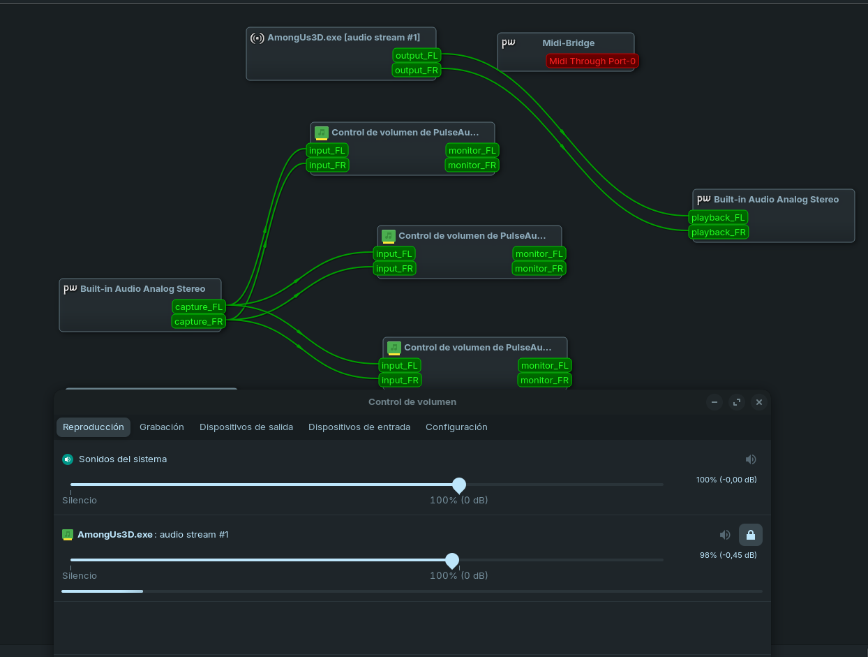

I tried this command that you post in order to force the game to use pipewire, and checking pavucontrol, i realized that in the first tab, wich its the reproduction tab, the audio registered from the game (the audio stream) it's responding when i talk in my mic, so when i talk, that little white bar that indicates the audio output of the app moves according to the level of noise that i am doing, and i dond't know if that its good or its the normal behavior (i post an screenshot of pavucontrol and the tool qpwgraph of my audio set up)
So maybe the game is registering or detecting the audio from the mic but doesn't stream it in game wich it's really wierd. I don't know if it's only me, maybe the original owner should try too, but at least, in some way the game it's registering something but it's not recording or streaming it (sorry if my english it's not the best)
