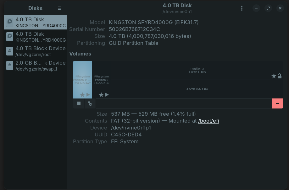

I'll admit I may misunderstand what I'm seeing, but my swap partition seems to exist outside of what's encrypted:

Naturally, which is why I'm somewhat concerned that I have a swap partition that doesn't appear to be encrypted. At install (I'm working from memory), the options are whether or not you want advanced settings. If you do, you get to choose to use ZFS and/or LVM. If you choose one of these, you may also choose encryption. There's no choice of what to encrypt, exclusions, etc.

I can guarantee you I never set any manual partitioning. I also don't recall an option at install time to enable or disable support for hibernation, although I feel like I remember seeing it on other distrbutions. I hate hibernation and go so far as to disable it even in windows to recover the space used by hiberfil.sys. It's entirely conjecture, but this feels to me like the installer intended to have a swap file, but made a swap partition anyway. At the time of 17.3's release, I mentioned very frequent errors at the point of writing the partition table that I more or less forced my way through, and that 17.3's installer felt much more problematic to me than 17.1's had.
...I hate to say it but right now I really mistrust the installer for 17.3. I don't believe anything was done maliciously, but something just isn't right, then or in what I see (in Disks) now.
It's my recollection that if I manually encrypt a partition that's needed at boot, I get separate passphrase prompts for each, which would make just encrypting my swap partition and calling it a day undesirable. :confused:
I am not sure. I can tell you that the full disk will be encrypted when choosing that option at install.
But if anything was created after and not probed to the swapcrypt; maybe it was not later...
I am not even sure at this time if your swap IS outside of encryption.
I am SOMEWHAT more comfortable now, and think Disks may just be presenting information confusingly.

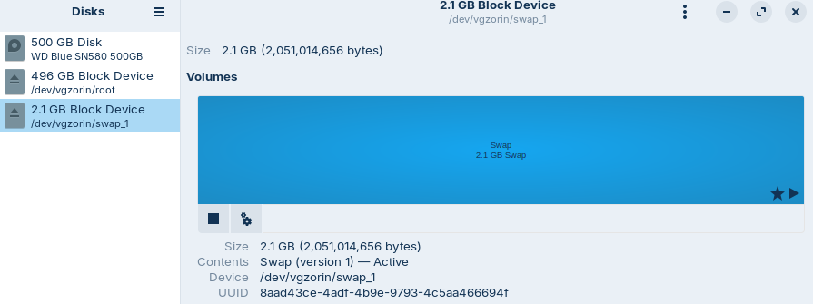

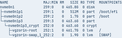

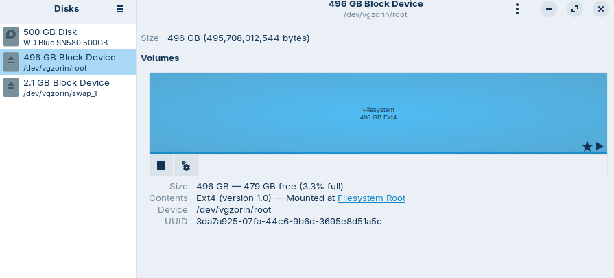

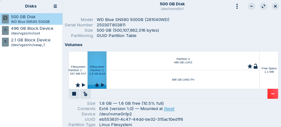

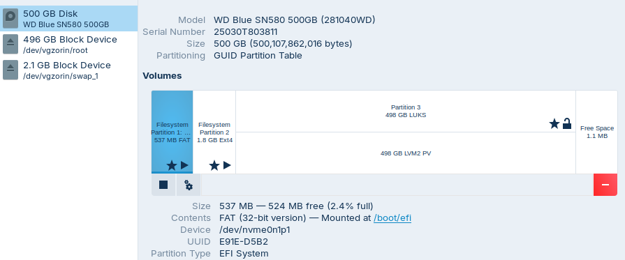

I used the auto feature of the OS 18 installer (peeked at manual partition, but backed out) and am confused by the result that I am seeing:
Both root and swap_1 are in /dev/vgzorin
What is the 1.8 GB Partition 2?

This is normal. Try using the lsblk command to see disks and partitions in a more useful way for this matter. It's the all text output I pasted above. If swap is under the partition marked crypt, then it's encrypted.
If you look up at the conversation @Aravisian and I had, he mentioned that /boot and /boot/efi need to be unencrypted in order for the system to boot enough to load LUKS (the encryption software), so it can read everything else. the 1.8 GB partition in your screenshot is /boot, and the 537 MB partition is /boot/efi. I still don't understand why Disks displays the swap partition the way it does, but your partition scheme looks identical to mine, so I'm fairly confident that lsblk will show your swap under the encrypted container.
Thanks! I understood about boot being outside the LUKS partition, but missed that boot/ and boot/efi were separate partitions. Everything is looking good and makes sense now.
