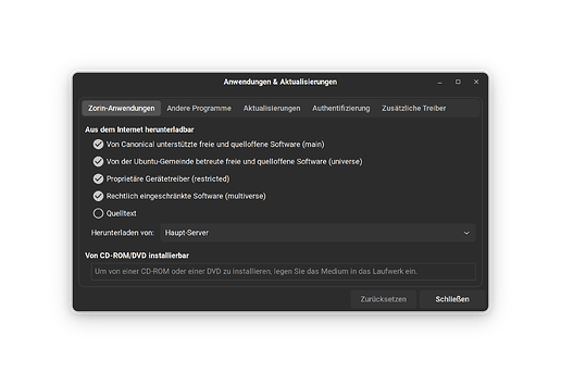

Looks like this:
The ''Additional Drivers'' Tab is the first on the right Side.
Yeah so i tried ist but IT says i didnt have an Internet Connection but i have! Should i Switch to the Host Server because i Love in Germany?
Let it on ''Main Server'' and open the Terminal and type sudo apt update && sudo apt upgrade and post the Output here please.
