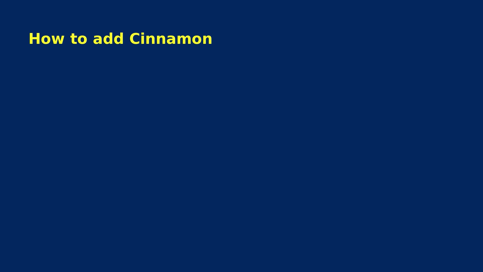

For anyone else, here is a video I created:
