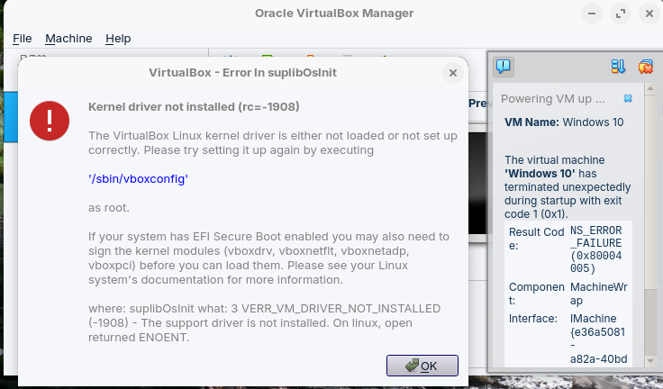

I’m trying to get VirtualBox 7.1.8. working but get the following message when I try to run a virtual machine.
I’ve looked at other post on the form with similar messages but I don’t understand the solutions given. Any help that could be given with step-by-step instructions would be great.

Sorry to hear of your issues with Virtual Box. Have you installed the Extension Pack? In the past I always recommended getting the latest .deb package fro the official site as the ones that get bundled with Zorin aren't the latest, plus the associated Extension pack. That said I no longer use Virtual Box having had a better experience with virt-manager which is what I use for my videos. You will need to install Synaptic Package Manager to do so. If you do go down the route of virt-manager (Virtual Machine Manager) I recommend you create a new pool in /home as by default, virt-manager wants to store VM's in /var which can soon get filled up.
Do you have Secure Boot in BIOS enabled? If yes, turn it off (with Fast Boot if available) and then try it again.

Thanks for your response. I thought I'd disabled secure boot but I checked again and it was still enabled. So now, the virtual machine starts but gets an error that AMD-V is disabled. I looked for virtualization in the BIOS but was not sure what it was called. Will look for AMD-V now.
Mike
Thanks for the help. Found the virtualization setting under Security in the BIOS and the virtual machine works now.
