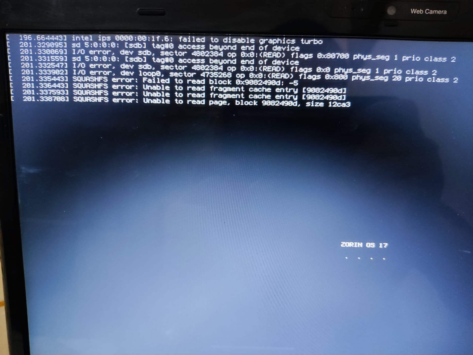

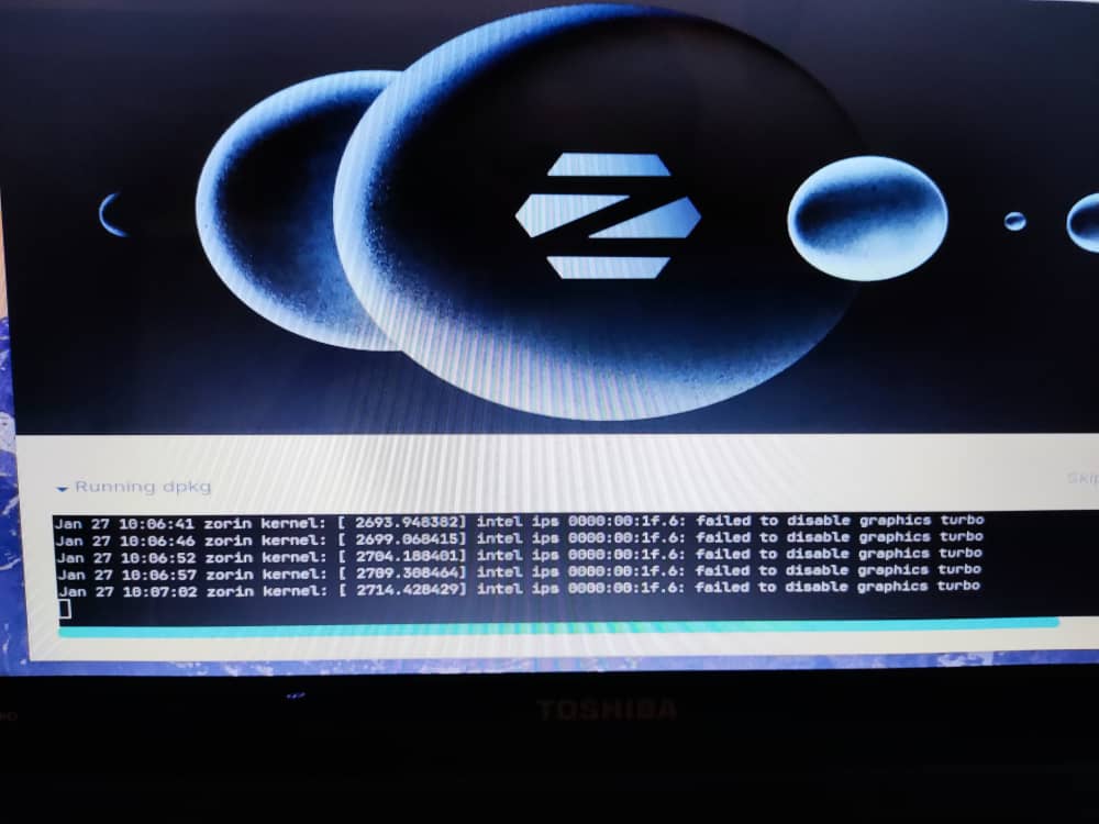

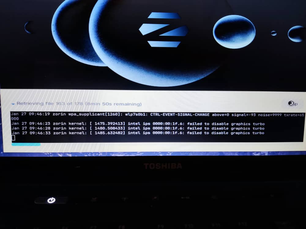

I have a TOSHIBA A660 laptop have intel i5 450M and GPU geforce GT 330M, and I attempted to install Zorin OS 17 using a USB flash drive. I tried installing it using the safe mode. However, during the installation, an error kept appearing.
After the installation process was completed, the system was unable to boot and crashed.

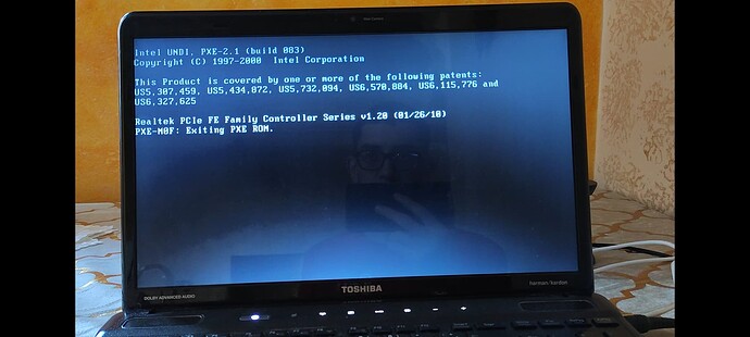

It can't boot after the instalation

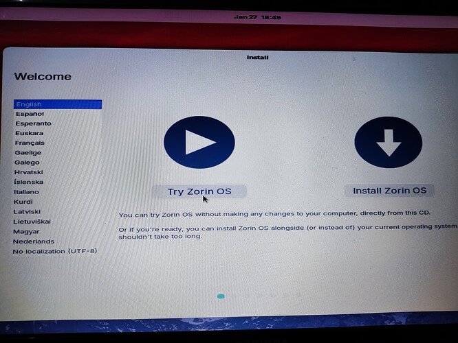

But i can boot with my udb drive and use the trying option

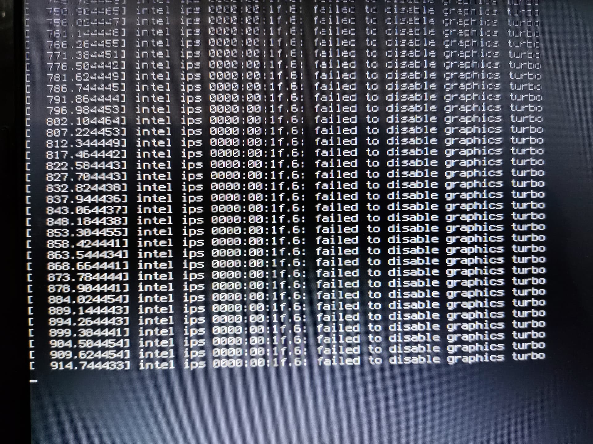

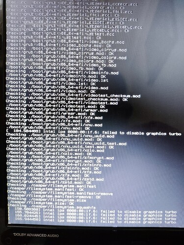

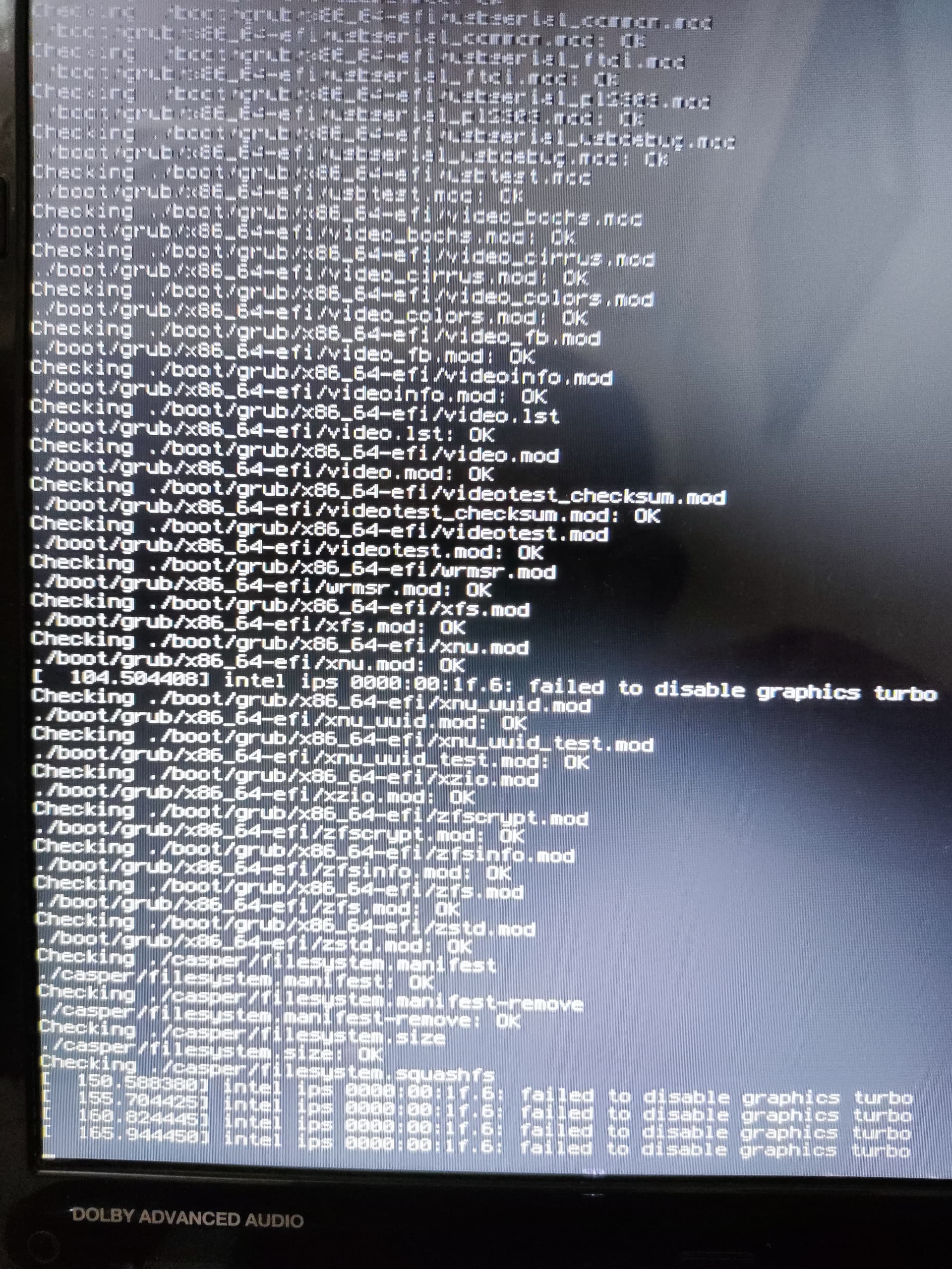

I m sure that i have GeForce GT 330M GPU

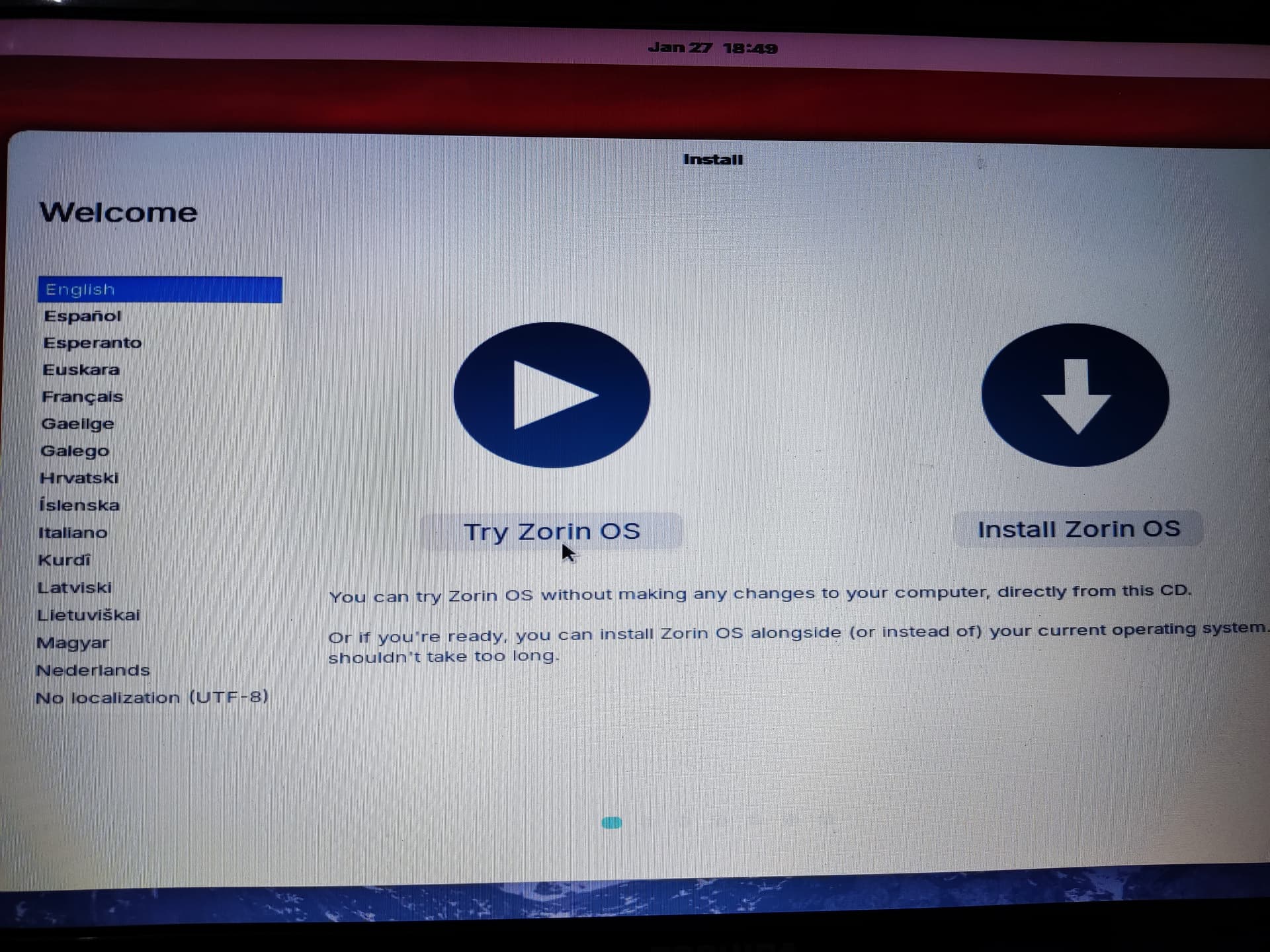

But i have probleme the option of tring zorin os not working
And he just keep showing that

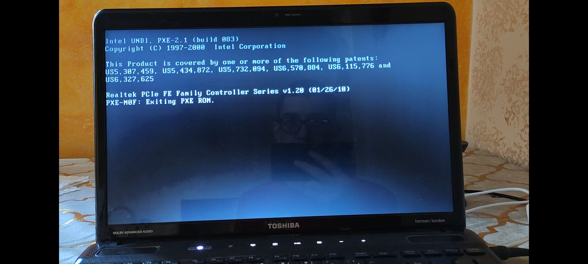

And when i pres the power button to force my laptop to shuydown it showme this message
