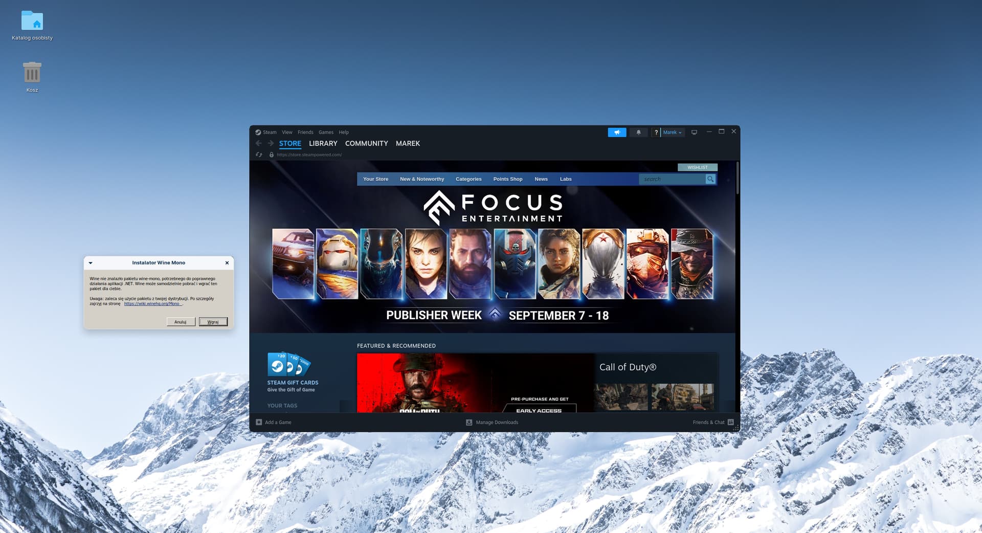

After installing steam flatpak.
I have some errors.
Why that many problems after fresh installation?
Why this want install wine if I never used that?
Because I have a Lite Prro version?
No, I think this is because you opted for the Flatpak version. Have you tried the standard Steam in APT (First, remove the Flatpak package for steam).?
sudo apt install steam
