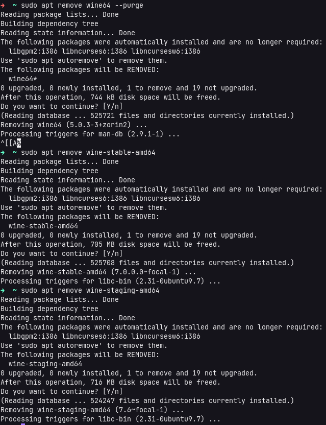

apt remove wine* didn't work so i did uninstalled these 3 manually:
