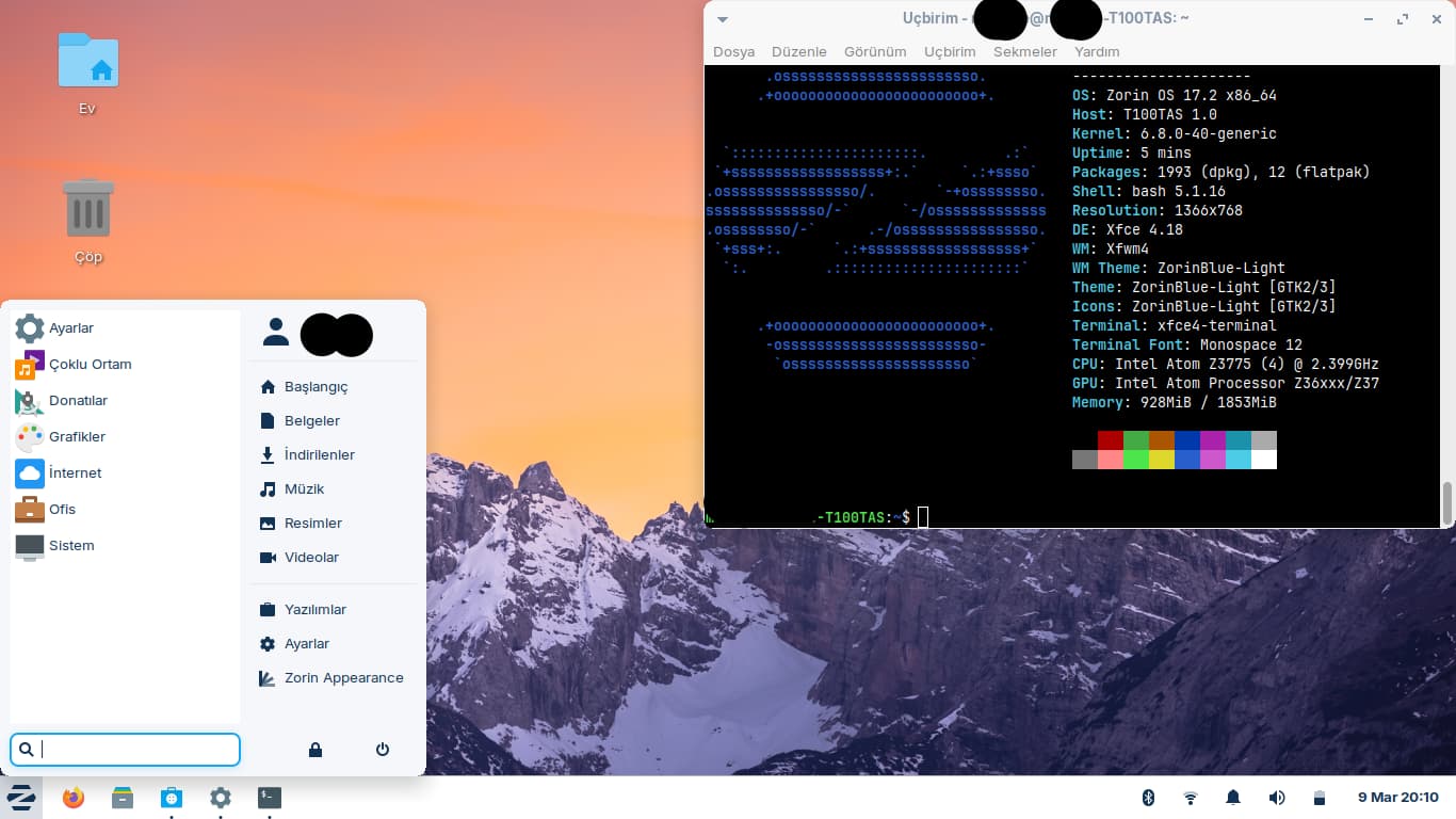

Hi everyone.
I have an old notebook (2in1) (Asus Transformer Book T100TA) which originally shipped with Windows 8 x86 (32bit), which is pretty much overkill for this tablet (you can barely open anything), which had only 32GB MMC flash, 2GB RAM and a weird Intel Atom CPU (Baytrail). So I needed a light and good GNU/Linux system which plays nice on a touch screen equipped old device.
What makes this 2in1 notebook weird is that the CPU is 64bit (x64) but the EFI is 32bit (IA32) which makes it impossible to use ZorinOS (or any other x64 OS) on this device normally. Because naturally 32bit EFI cannot start a 64bit operating system. In fact it won't even recognize the ZorinOS installation media, and even if you install ZorinOS on this device with a tool that has 32bit EFI support (like Ventoy), it will actually succeed but when you restart, you will see that your device won't even recognize its internal MMC drive in the boot list.
Reading a few other experiments on the internet and trying some theoretical implementations, I managed to install ZorinOS Lite on it and it works pretty good. (I also installed Alpine x64 before, if you are interested, you can check this guide on Github, it was very smooth for me but I couldn't get around a good desktop environment, maybe you can try others for experimenting.)
This method applies not only to this model only but also should apply to all other similar devices.

All devices except webcam are working. (This webcam doesn't have a GNU/Linux driver.) Touchpad is sometimes freezing for me, I don't know why; but touch screen handles everything for a mouse. You better enable the screen keyboard for tablet mode and remove the packages you don't need for optimization. Because you know, this device is very low on resources.

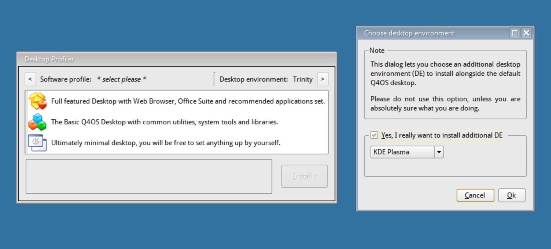

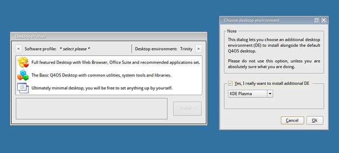

So hang on, how did you install Plasma on 32-bit? Q4OS only makes 32-bit TDE (Trinity).
I thought so too because its kind of hidden away.
  1. Choose Desktop Profiler, then Desktop environment at the top right of the dialog box; it shows Trinity by default.
  2. Click on the > icon and a Choose desktop environment dialog box will popup.
  3. Click on the drop down box, choose KDE Plasma and check the Yes, I really want to install additional DE.
  4. Click on OK and it will install the chosen DE.
Easy peasy!
The available DEs are: KDE Plasma, LXQT, XFCE, LXDE, Mate, Bungie, Cinnamon, Gnome and of course, Trinity.
