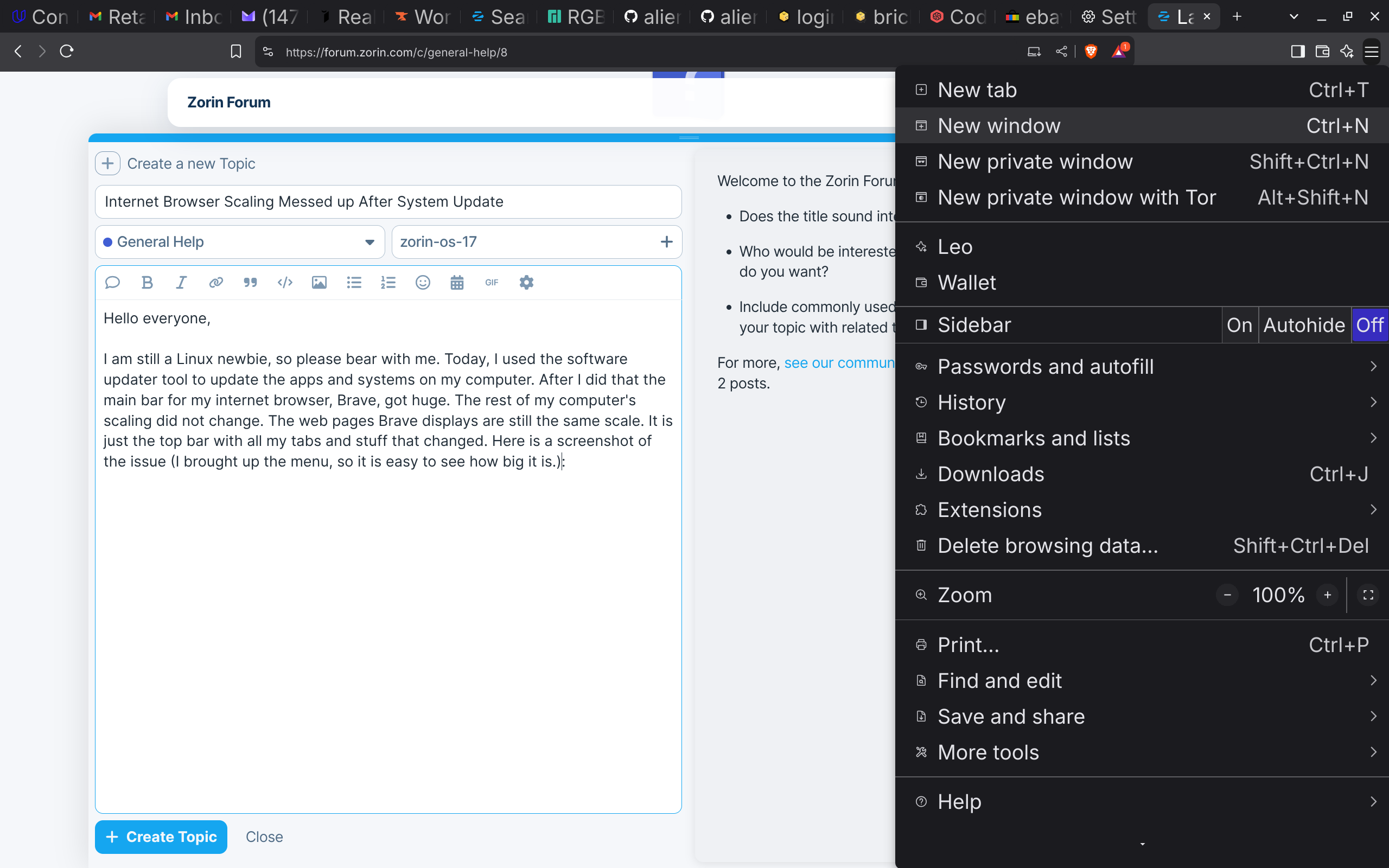

I am still a Linux newbie, so please bear with me. Today, I used the software updater tool to update the apps and systems on my computer. After I did that the main bar for my internet browser, Brave, got huge. The rest of my computer's scaling did not change. The web pages Brave displays are still the same scale. It is just the top bar with all my tabs and stuff that changed. Here is a screenshot of the issue (I brought up the menu in Brave, so it is easy to see how big it is.):

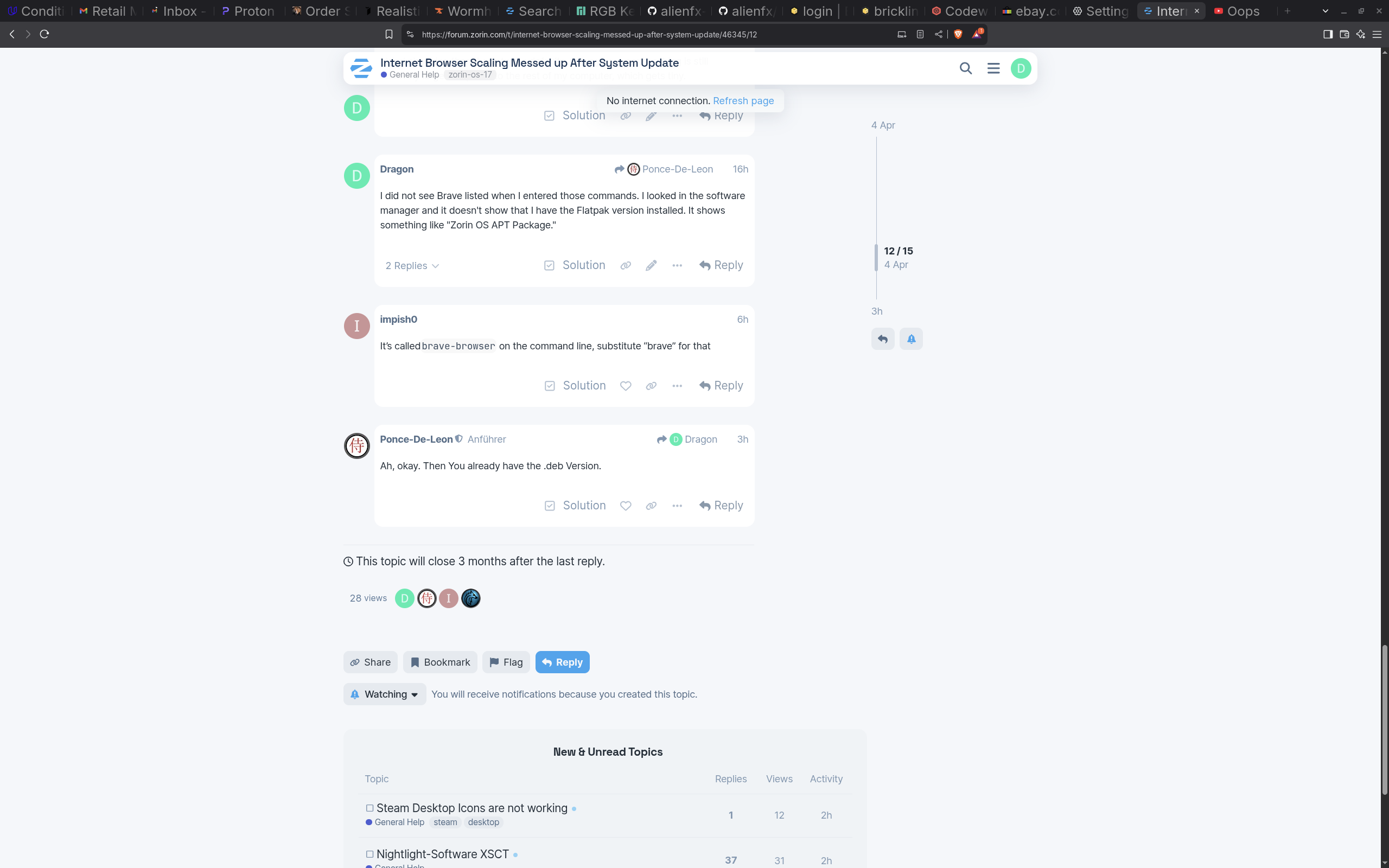

Alright, I tried the command Aravisian gave me and it did the same thing as when I opened the browser after setting my device scaling factor to the default setting. The top bar is still relatively large compared to the rest of my browser. the terminal also gave me this error:
[8676:8693:0405/082355.049245:ERROR:nss_util.cc(344)] After loading Root Certs, loaded==false: NSS error code: -8018
Fontconfig error: Cannot load default config file: No such file: (null)
I also took a screenshot of my browser, which you can see below:
Does this mean it is just a bug in Brave? The scaling on everything else was fine after the update.
I would agree and a couple other uses saw some scaling issues with Brave Browser.
