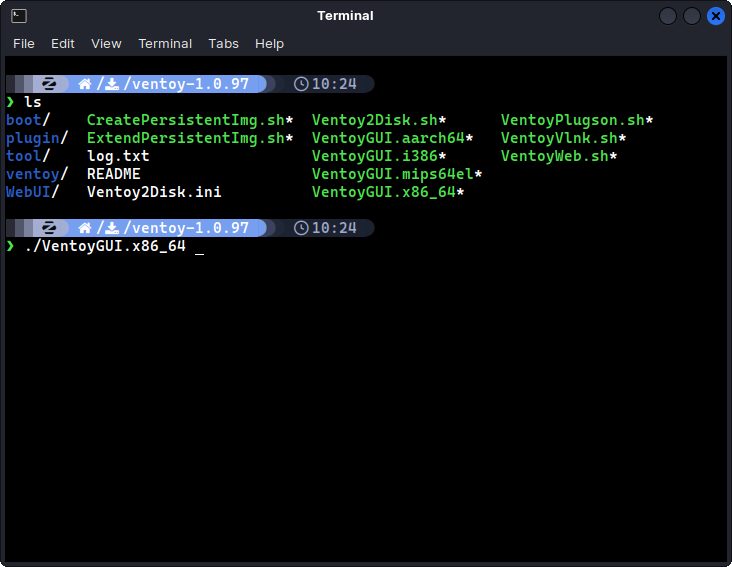

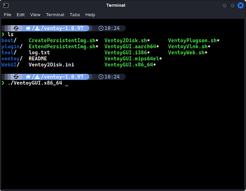

If you look inside the Ventoy folder there is a file named VentoyGUI.x86_64
To run this file just type:
./VentoyGUI.x86_64
It will open Ventoy application and you won't need the Browser to open it anymore.

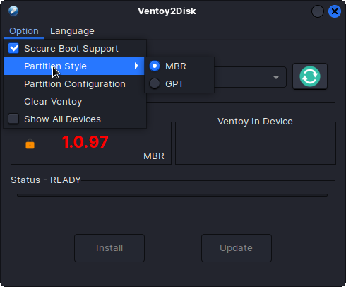

Then on the top left side just below the Ventoy logo you will find Option.
From here you can choose between MBR and GPT
Screenshot_2024-04-14_10-25-53
Keep all other options default and click on Install. When it's done rest of the process will be same as mentioned in the blog.
I did as you suggested and I was able to create bootable Zorin 17.1 Core USB. So I installed it on my Dell Latitiude e5430 and - - - it did the same thing! "Invalid partition table!". I know I created it for MBR, I double checked.
I have come to the conclusion that Zorin 17 is inherently set up for GPT, so it doesn't matter what program I use to create a bootable flash drive.

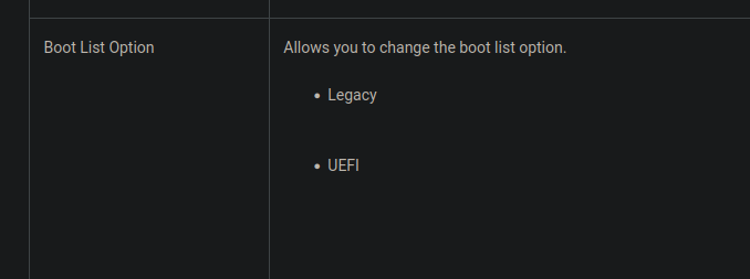

Were you able to get into your BIOS by chance? See if this helps - Dell and many others usually are F2 to get into BIOS; and this model looks different than the one you have but, should be the same:
In the BIOS settings - take a look for anything relating to Legacy / CSM options, if available have these disabled. Same for Secure Boot to install; you can set this up later if need be but, definitely disabled for install purposes.. Also. if you see any RAID or disk options have that set to AHCI; RAID doesn't really work OOB with most distros.

In that case I will suggest Switch to UEFI from Legacy.
From your given Device's model I found that it supports UEFI
And it's recommended to update your BIOS if updates are available.
Then you can install Zorin in UEFI & GPT partioning. I hope this will fix the issue. If you try this let us know the results.

You were correct, I used F2 and got into the menu. I changed it to UEFI from Legacy in the Boot Sequence menu option.
Unlike the video that was posted by PlumpKibbles - at .50 when he changes it to UEFI the boot sequence above it just "disappears". When I did it the boot sequence changes from a list of HDD, USB etc to just "UEFI Hard Drive".
So I thought well that won't allow me to boot from the USB. But I was able to check the box next to it to in effect turn it off.
Then, under Secure Boot it says Disabled and the Legacy Option ROMs is off. So, hoping that would mean I could still select USB to boot from when I restarted and pressed F12 and selected USB.
