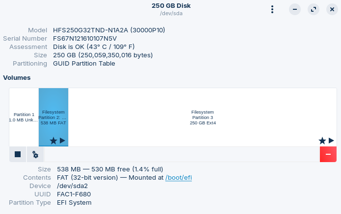

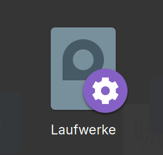

You can use the built-in Disc-Tool. It looks like this:

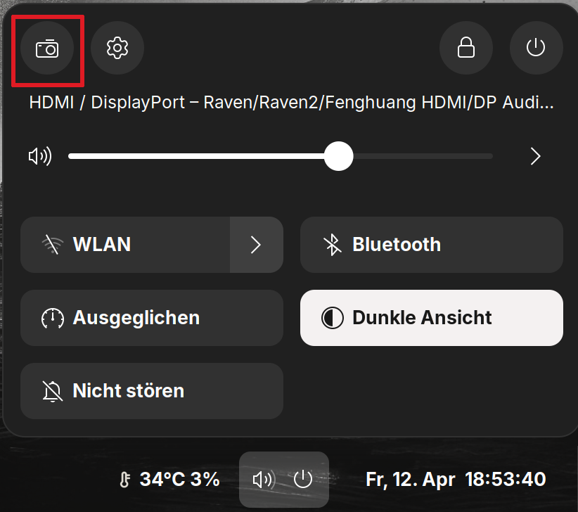

For the Screenshot You can simply push the prnt-Button if Your Keyboard have one. If not go to the Quick Settings (the little Symbols in the Corner click on them) and there is on the top left a Camera Symbol. Click on it. Look here:
Also please be advised that in Zorin 17 the screenshots were moved from just the Pictures Folder to a folder with in the Pictures Folder named Screenshots ..... it took me forever to find this out .....
Ok I ran the tool and screenshot everything it had. Here are the results:
You have GPT partitioning.

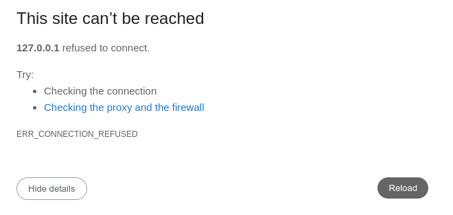

Well I didn't get far. I followed the instructions until I got to the part where I am supposed to go to Ventoy server with URL. Here is the message I got.
site can’t be reached
I tried turning off the firewall UFW, but it still didn't work.
