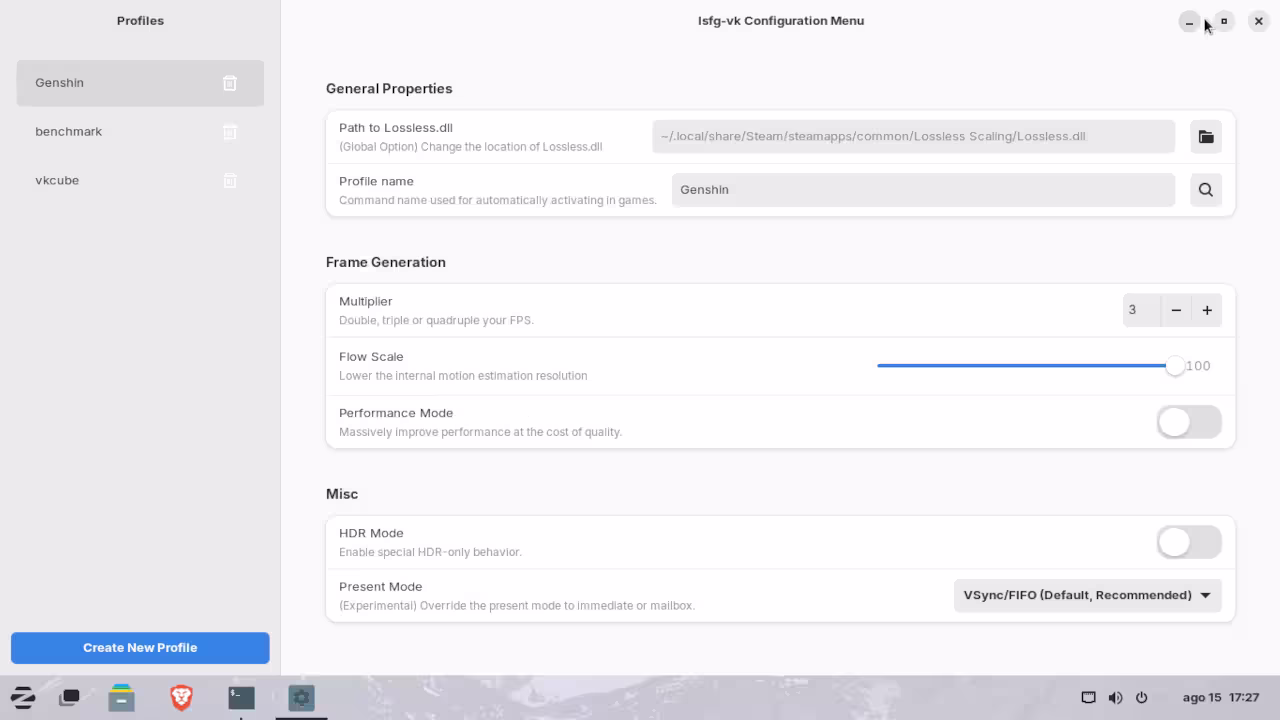

Appreciate the attention, but no dice.
Though I did learn a bit from your reply; I tried the flatpak method but it was a bit confusing for me, so I decomplied the .deb file with dpkg, deleted the specification that it has to be libc6 2.38-1, recompiled and installed. It did open, had the proper icon, and could be searched on the taskbar, but the frame generation feature didn't work.
Thanks a lot regardless!!
