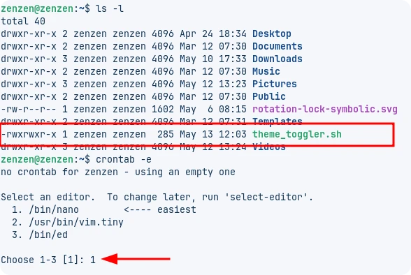

Save this file as something like "theme_toggler.sh" in your home folder. Then, type crontab -e and insert this line at the end.
*/30 * * * * $HOME/theme_toggler.sh
sc1
The first time you run this command you might be asked which text editor you want to use. If you don't know select 1 and hit enter. Then, add the line at the bottom which will instruct the system to run this script every 30 minutes. To save the changes press Ctrl+O and exit with Ctrl+X.

hi @zenzen, thanks for your reply. I followed your isntructions and it worked very well, thanks. Only issue is the shell theme didn't change but thats okay, is a small thing.
I also did a small "improvement": created a .desktop file that executes the script and configured it to start with system using gnome tweaks. This way I will not have the issue with the computer taking 30 min to change the theme if i turn it on 18hrs like you mentioned.
