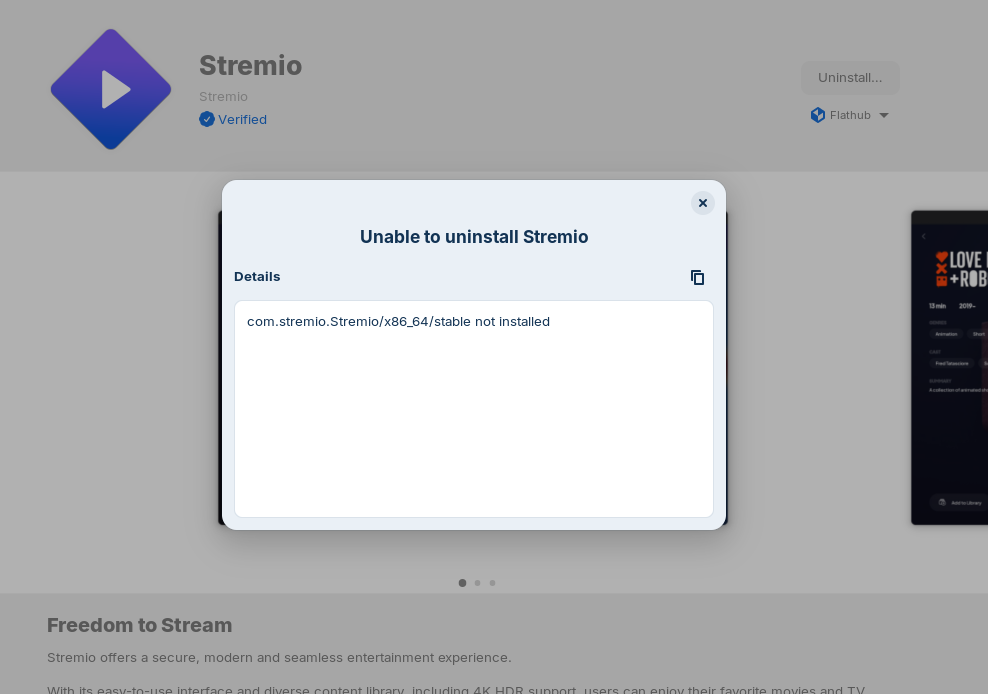

I am trying to uninstall and reinstall Stremio, but when I try to uninstall it, I get an error.
what do I do? I can't install or uninstall at all.

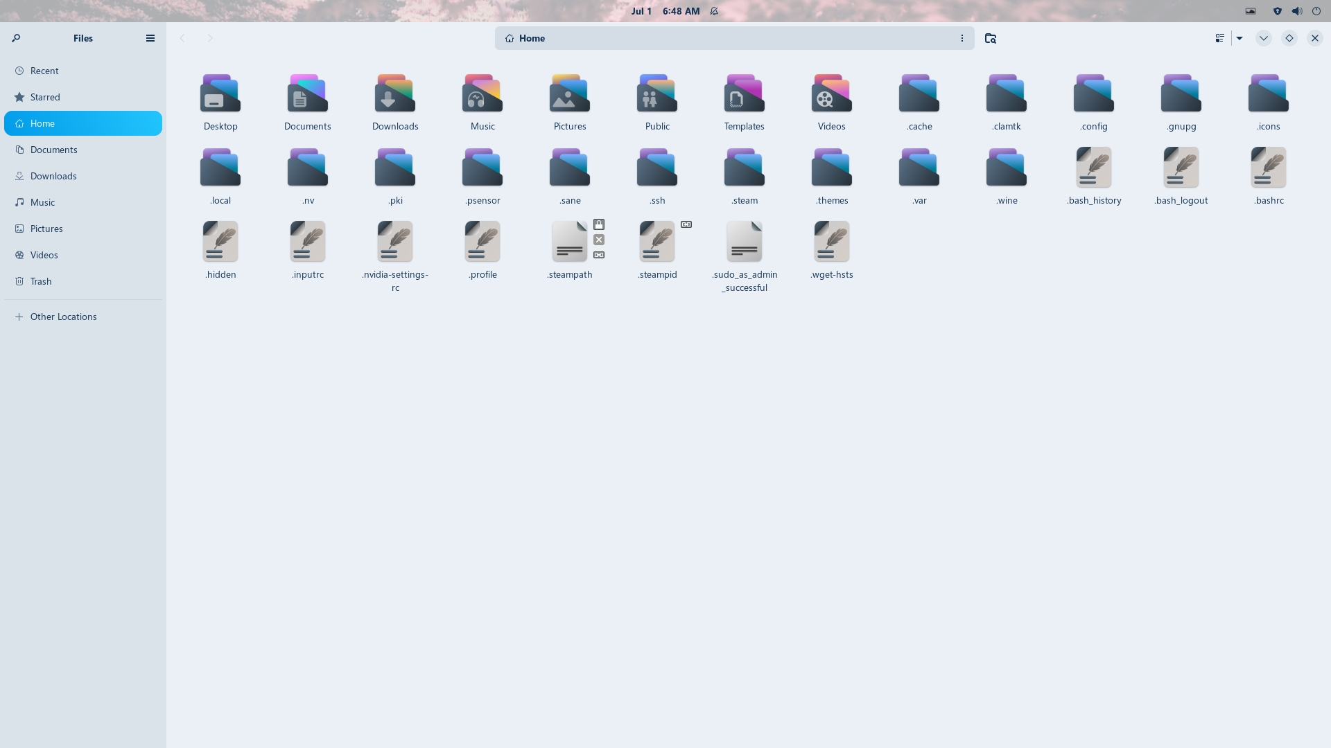

ok that has to be removed manually to do this open files then control+h to show hidden folders then open .local then share then smart then code then ltd delete all thats in that folder and that should remove that program
pic of hidden folders

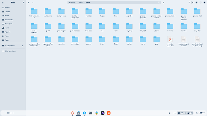

I can't find smart in the share folder
I searched for everything related to Stremio file-wise and deleted it, but some folders keep showing up even though when I try to delete them, it is not part of the file directory.

Look at the arrow button of your screenshot which package format has a :check_mark: and is shown as installed.
Open the Terminal and use the Command flatpak list to get a List of all installed Flatpaks. And check there if the Program is listed.
