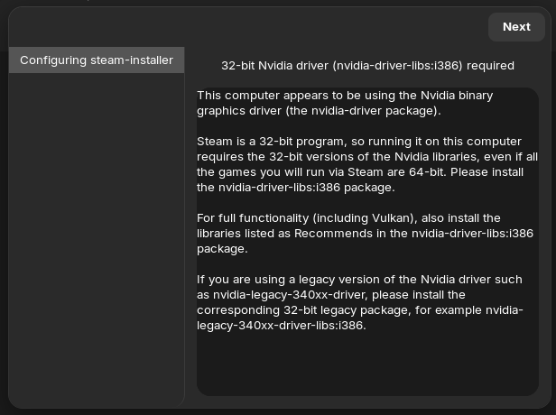

However, now I'm getting issues with Steam closing every minute or so. I initially installed the package so I can store my games on another drive, and used the terminal to run sudo apt install libnvidia-gl-550:i386. So I'm thinking its possible I might have installed the wrong version.
Here is the popup I received:
How exactly do I install the required 32bit versions of the libraries, as well as the recommends for vulkan support?

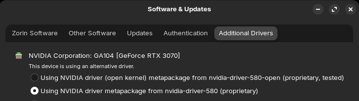

I've already wiped and reinstalled Zorin. However, I'm kind of lost as far as what to do at this point.
Checking my drivers, I already have the 580 drivers installed, and they were installed from the start, which if the 32bit libraries are included why is it prompting to install them?
But the picture I sent earlier seems to be asking for something else. A 32bit version of the Nvidia libraries, as well as a recommended library for Vulkan support, which I want. Are these different from the drivers I already have? Or does the driver already include those packages and the pop up is more a warning?
You could try
sudo apt install libnvidia-gl-580:i386
You should not be getting such a warning - your regional server is not properly syncing with main.
From Software & Updates app, switch "Download from" to Main Server
Then sudo apt update and install steam.
I do not recommend trying to install the package manually - since this can often result in the system trying to replace your critical 64bit system files with 32 bit. This will break the system.
Ultimately, this is a fault of regional servers not doing proper maintenance.
