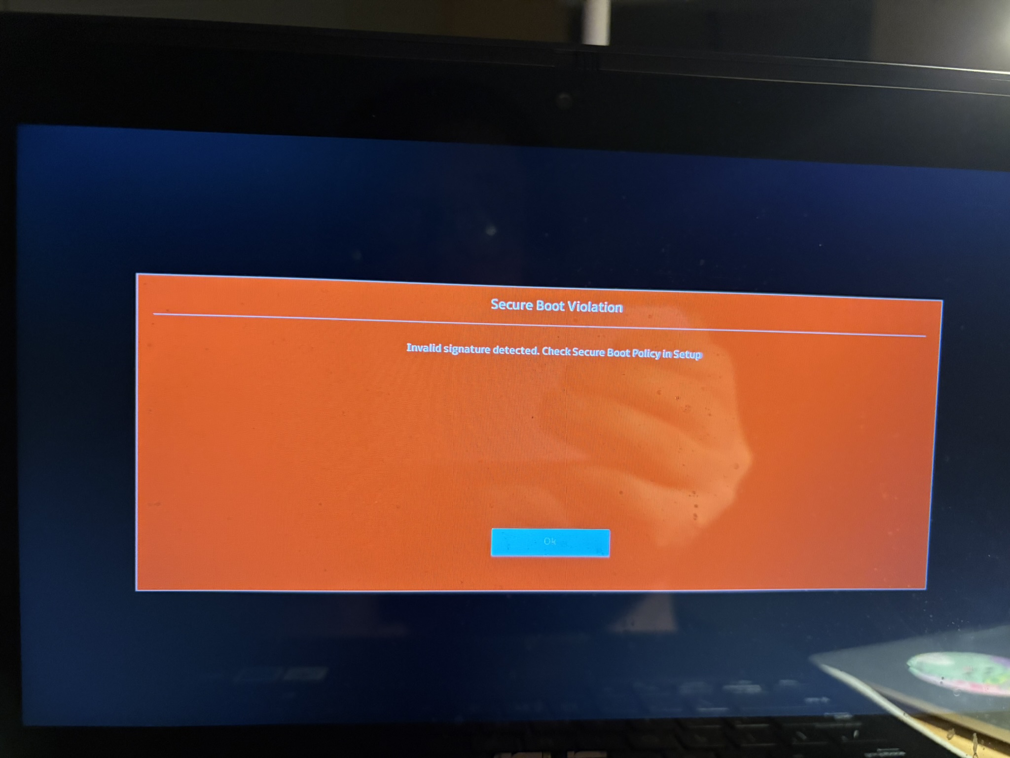

I am having issues with updating the Secure Boot Firmware from 2011 to 2024. Every time that I attempt to download and install the update from the Software Store, it returns an error (see enclosed screenshots). I have also tried running the following commands via terminal to no avail:

sudo fwupdmgr get-devices
produces the following error for UEFI Signature Database:
Update Error: Snapd integration for DBX update is not available
(see enclosed screenshot)

[SOLVED] The issue has to do with Zorin OS 17.3 which is not supported by Snap version of Fwupd. I ran:
sudo apt update
&& fwupdmgr refresh --force
&& fwupdmgr get-updates
&& fwupdmgr update
in my other OS (Linux Mint Mate 22.1) and it updated UEFI dbx to the current (20241101) version.
This issue needs to be addressed by the Zorin Development Team.
