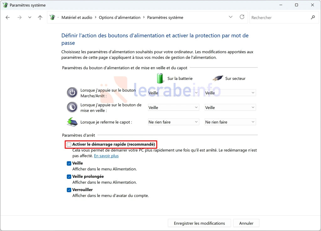

I am running zorin pro. I am dual booting windows and I already have fast boot turned off, on the windows side. Additionally I don't get any of this packet loss when using the same port on windows. I have usb c to 2.5gbe ethernet adapter that I've been using and it doesn't get any packet loss at all.
