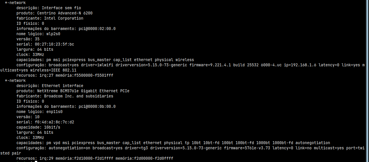

By the way, here's the wifi driver information:
Help me to solve this problem please, I really like that system :confused:

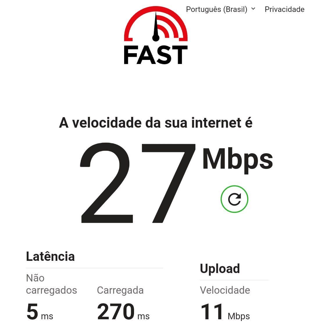

Hello Ocka. So, I'm running just Zorin Os, and I'm not running Ethernet and wifi at the same time, just wifi. Well, I tested my wifi connection speed on two devices, my cellphone and laptop(where I'm running Zorin) from the same distance and network, here's the result:
Cellphone:
Laptop:

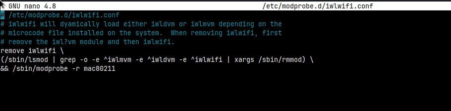

Hello Aravisian. So, when I try to use sudo nano /etc/modprobe.d/iwlwifi.conf in terminal, this is what happens:

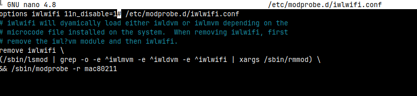

I don't know exactly what I should do here, when I try to append options iwlwifi 11n_disable=1 to the end of the file, this goes to the beginning of the file:
It's my first time using linux, I'm still studying about this system, sorry if my questions are silly.

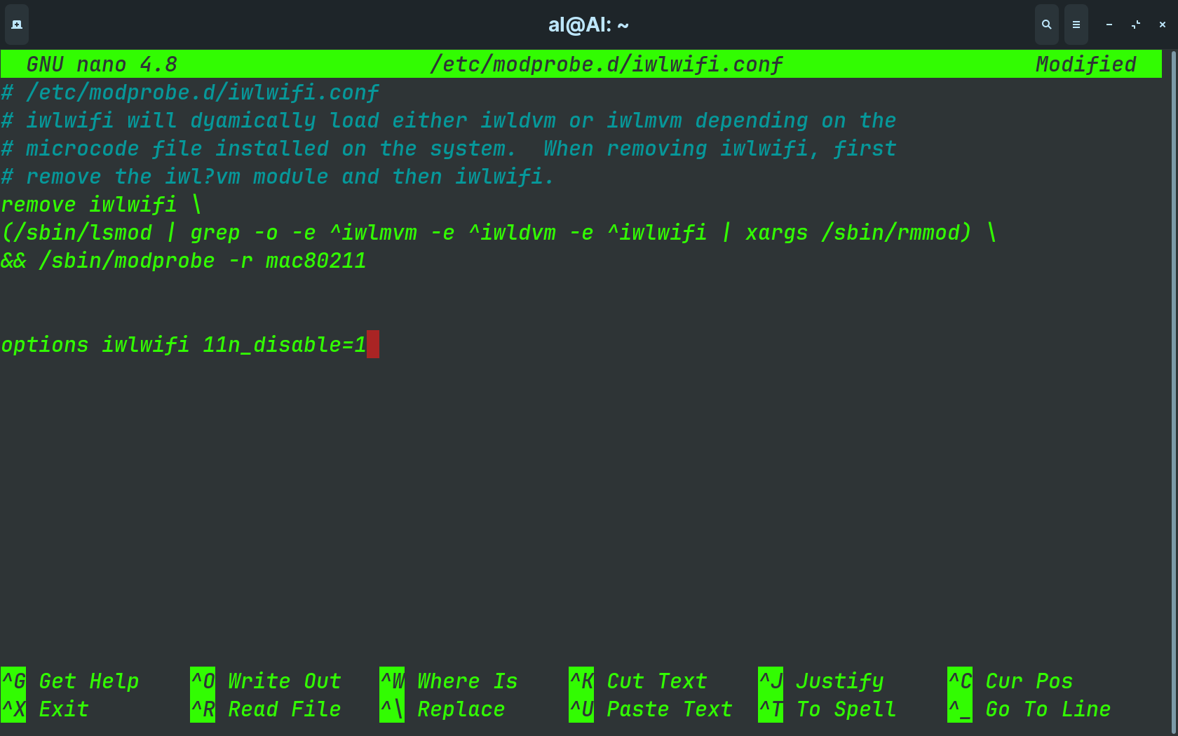

stop.
undo what you have done,
In the terminal you need to use your "Arrows" to move the cursor.
move down to the bottom the click "Enter" a couple of times, ( like in a txt file)
& add the command, then "Exit" & "Save".
Reboot after changes.
I still recommand you check for BIOS updates.
ADDED: just incase, to Exit the nano file, down the bottom says ^X this is.
Ctrl+x
Then next y to save changes.
then Enter.

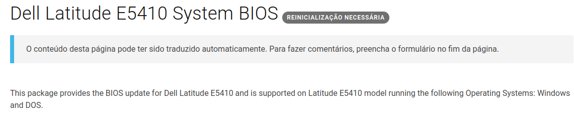

I searched for a BIOS update in Dell support site for my Latitude E5410, but it says that update is supported for Windows and DOS.
I'm not sure if I should update BIOS, my laptop is old and I'm afraid that my motherboard will malfunction or even stop working after an update, since this is a delicate process... By the way, when I changed the file you guys told me to edit, this improved the wifi connection speed a bit, but it's still slow. Maybe that ubuntu version doesn't work correctly in my wifi driver just like Aravisian mentioned above. Anyway, thanks for your help. :confused:

As a side note, my laptop is slower than my phone,
22mb D/L 10 U/L
laptop:
15-18 D/L 10 U/L
