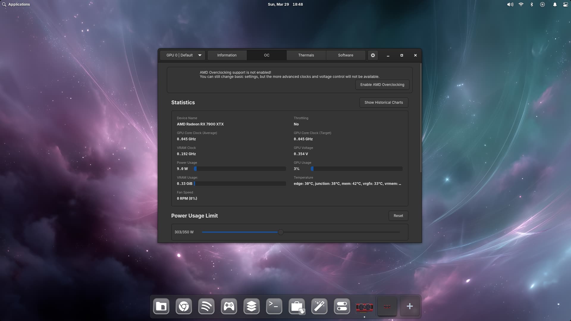

I use LACT for that purpose.
Installation (flatpak):
flatpak install flathub io.github.ilya_zlobintsev.LACT
It require that you give it permission to run outside its sandbox, after that a restart is needed.

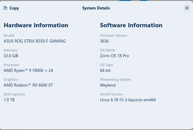

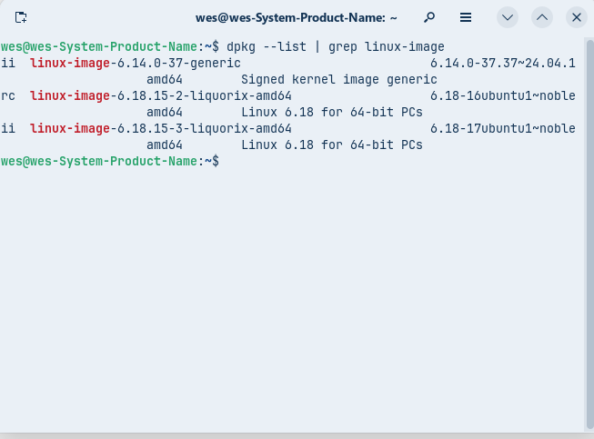

its possible mine is differnt then what most are using in OS 18 #1 i dont have any of kernel 6.17 installed i do have 6.14 and my current kernel is 6.18.17 and its backup of 6.18.16 thats all i have to make OS 18 extremely stable for my setup. this maybe why the cooler control works i know it does need a few things but it will depend on dependencys..as always. works awsome on my system which i will post below
maybe this is why it works for me
here is my image grep

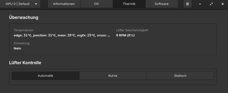

I installed LACT and set it as root.
I can turn on fans there, or set it to automatic.
So I see, software and fans are "connected". Is this everything to do?
At wich temperature should "automatic" start?
GameMode is installed, but I think it turns of after starting the game.

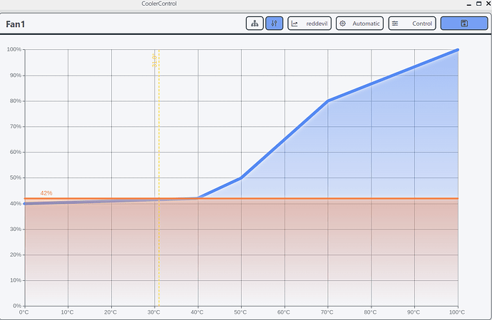

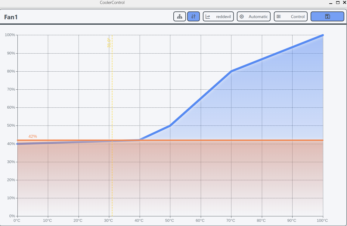

i see something at bottom like curve....is that how you set the fan curve?
Yes it is
ok if it lets you set the curve set it to something like this....
then save it
