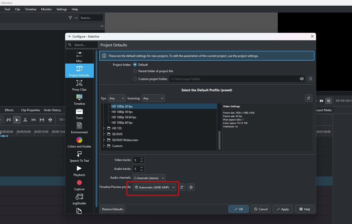

When I use Windows and install Kdenlive, Kdenlive detects my GPU. But when i m using Zorin OS or any other distro, I can't see this. Only "VAAPI". Any idea or solution for this?

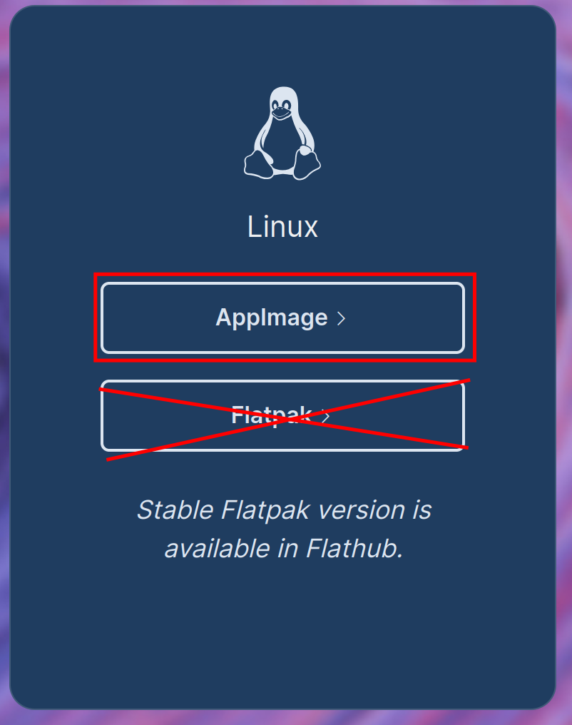

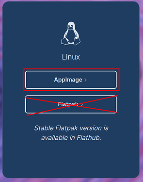

Or You could use the AppImage instead the Flatpak Version, what You can download here:
Look for this:
I know that the appimage version of Kdenlive automatically recognizes the GPU on my computer with an nvidia card.
When You know that, You could use the AppImage.
