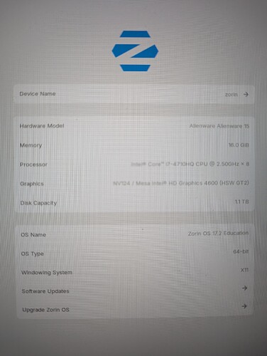

Is Your System running in Wayland or Xorg? Please check that in Settings>About and look if there stands Wayland or X11. If there should stands Wayland, You could try it with switching to X11/Xorg.

According to the About Window it's running on X11

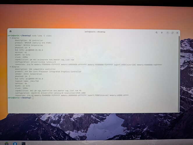

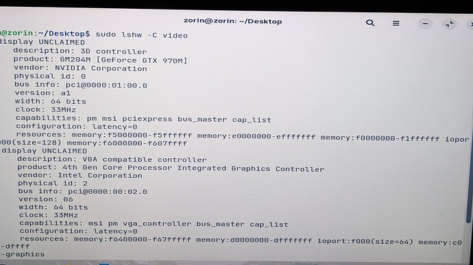

Ok so I assume you have an nvidia gpu in this as well? If you aren't sure you could run a check with
sudo lshw -C video

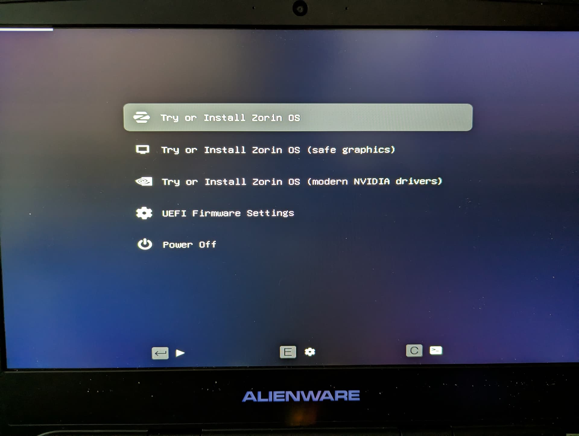

In the terminal and we can see from there. How are you booting from the usb? With the open source drivers or the nvidia drivers?
Yes it's an Nvidia GPU GTX 970m
Booted under Safe Graphics
Booted under modern NVIDIA drivers:
I have tried all three options listed here:
